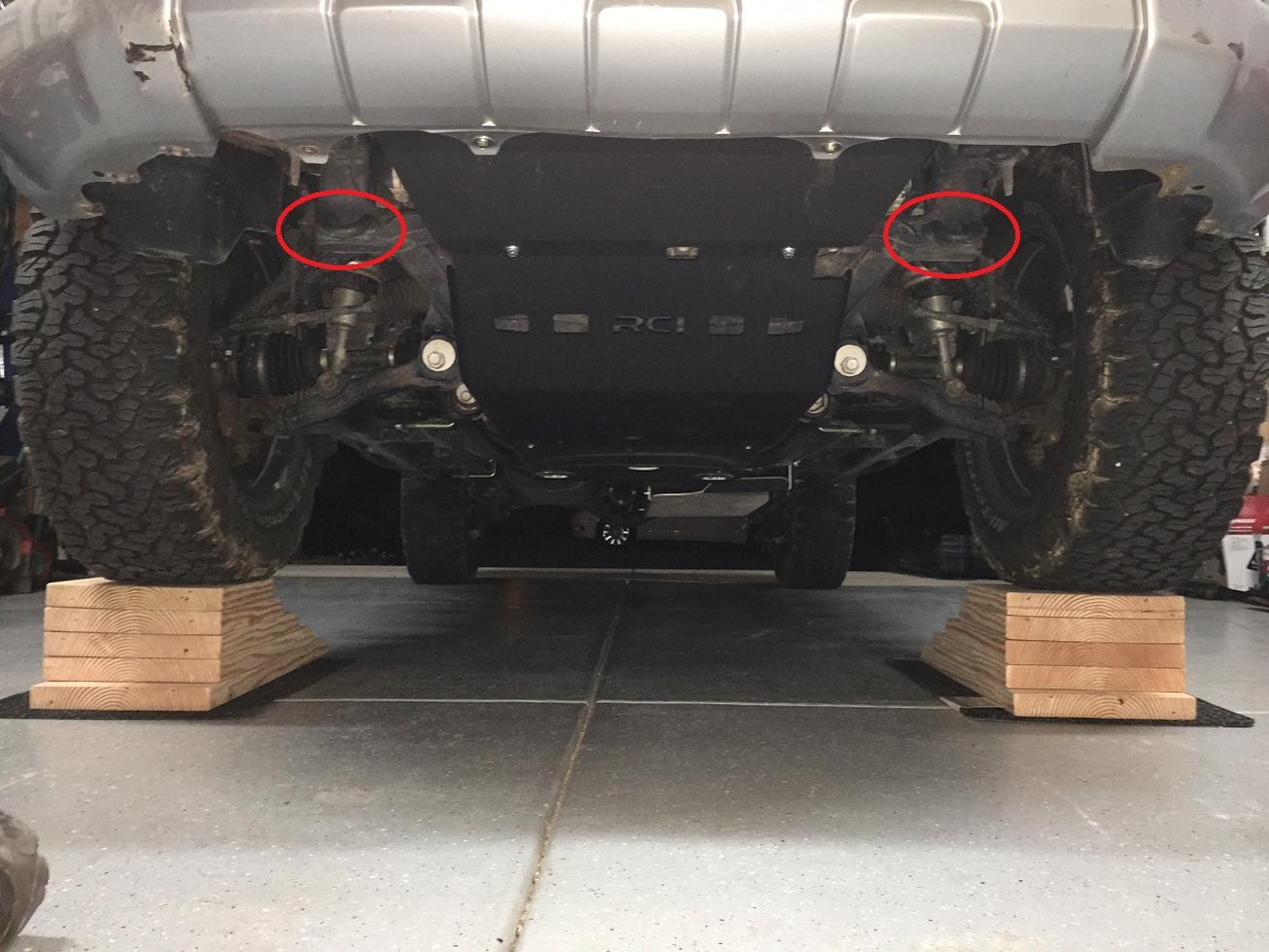

For recovery from the front, I use shackles hooked to the factory points (see red circles in first pix attached below). The "legs" go through the frame and are welded on both sides and have been robust enough thus far.

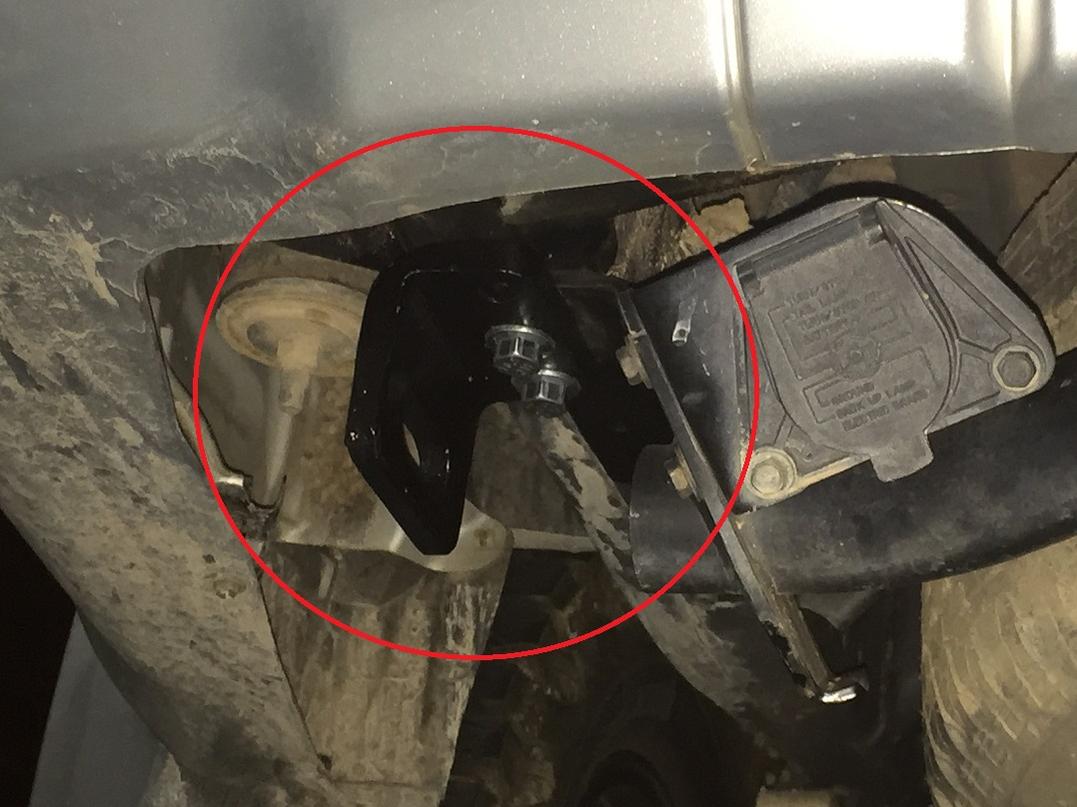

For rear, I was able to get in on Inv4drZm's custom solution (link: http://www.toyota-4runner.org/group...ear-recovery-point-group-buy.html#post2610210). See second pix. Before this... I used a hitch-mounted shackle (like this one: https://www.amazon.com/Smittybilt-29312B-Receiver-Shackle-Receivers/dp/B001CF1A7O)

[MENTION=142877]Folsom4Rnr[/MENTION] - I had reached out to Inv4drZm and found he was sold out of those rear brackets.
[MENTION=123332]Drunner97[/MENTION] - Looks like those got good reviews from a lot of people, and the price looks decent. I will consider that solution.
Thanks for the info!
