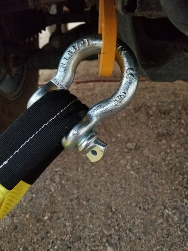

I installed front recovery points on my 2017 4runner SR5.
Before I have to use them I have a few questions about the safest technique.

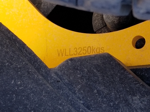

Each recovery points (2) are rated 7,165 lbs each.
My bow shackles are rated 8,000 lbs.

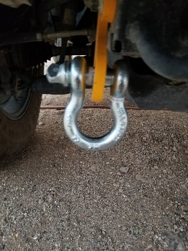

My first concern is the difference between the thickness of the recovery point and the opening of the shackle.
Particularly when the load is at an angle, best case would be a straight pull using both recovery points.
Would it be safer to flip the shackle upside down?
These recovery points have squared edges that would not be good with soft shackles.
I am prepping some rear recovery points that have rounded edges that I'll use with soft shackles.
So for the front, using the bow shackles. What is my safest option?

My concern, even using a bridle, is single shear vs double shear where the shackles pin contacts the recovery point.
Maybe a bushing to keep the shackle centered, so it doesn't twist to the side. Something like the Factor 55 "spool"

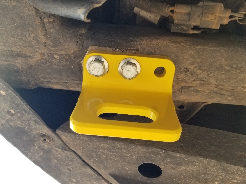

I don't think the shackle will matter much. The attachment to the frame is the weak point. It's two relatively small weld nuts holding into the wall of the frame tubing that is relatively thin. I'd be mostly worried about the tear out strength of the two attachments to the frame rail. Those will probably give long before the shackle or the recovery hook.
I would not pull sideways at all on the near side one. It will rip the welded front nut out without too much effort (I'm assuming you haven't put any reinforcement inside the frame rail to spread the load out).

Is your concern that a pivoting shackle might deform the recovery point? or rip it out of the frame? Again, the bridle will mitigate this, assuming you follow all other safety/best-practice methods.

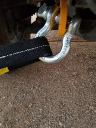

I'll use in this orientation. With a bridle strap. And hopefully never at this angle.
As someone on another forum suggested, this way the recovery point isn't trying to open the shackle.

OEM hooks pull from the same point on the frame as these aftermarket ones, and at least the aftermarket ones are bolted to two separate parts of the frame instead of just the radiator support crossmember. And I would guess the recovery point would bend before the frame would.

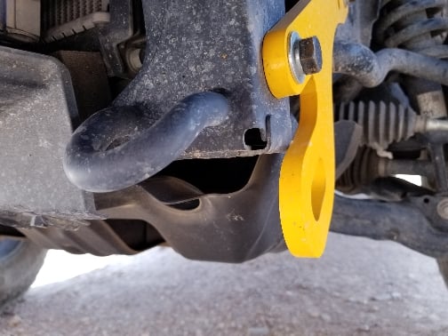

I've read the loops as recovery vs tie down. I see both trains of thought. For sake of discussion I will refer to factory tie down (TD) or aftermarket recovery point (RP).

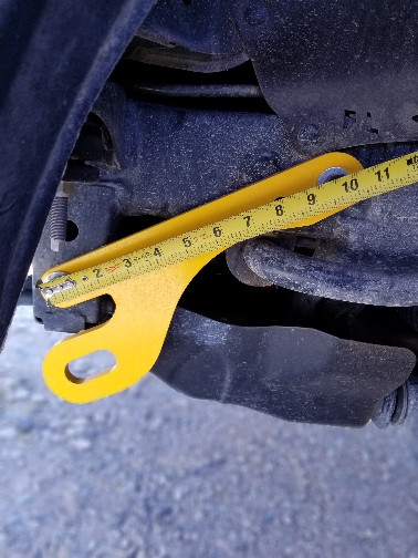

The TD, on the front, is a loop welded to a bracket of frame material, welded to the radiator support with a bead front & back of the loop. They are not "rated".

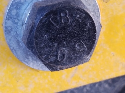

The RP is "rated" and is attached with grade 10.9 bolts, 9¼" apart, to the same spot as the TD & the main frame. It is one piece ½" thick.
As you can see in the first picture I have both TD & RP. I was thinking of using the bow shackle in the RP and a soft shackle through the TD and the loop of the strap as a backup.
I don't do bling. They are a bright color to make them easier to find by anyone during a recovery. Someone with more experience than me may notice the TD and determine that may be a better choice for the particular situation. I left myself with options.

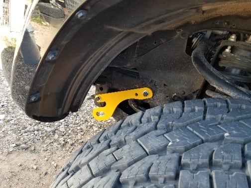

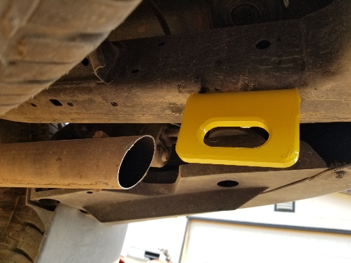

In the rear there is one TD. A loop welded to a .20" thick piece of metal. It has no markings on the bolts.
I have replace it with two one-piece, ½" thick RP, with grade 10.9 bolts. I also have the receiver hitch RP. Again, as many options as possible at this time.

With the design of the rear OEM, vs the aftermarket, i'd use the aftermarket. based on the orientation of it's mounting location. That and the fact that I'd see the OEM bending before the aftermarket.

I’d say the curved part of the shackle goes in the recovery point with the pin holding the end of your strap. You can use a tree saver strap as a bridal to halve the load. Just slide the the tree save through the open end of your recovery strap and connect it to your recovery point with some shackles.
