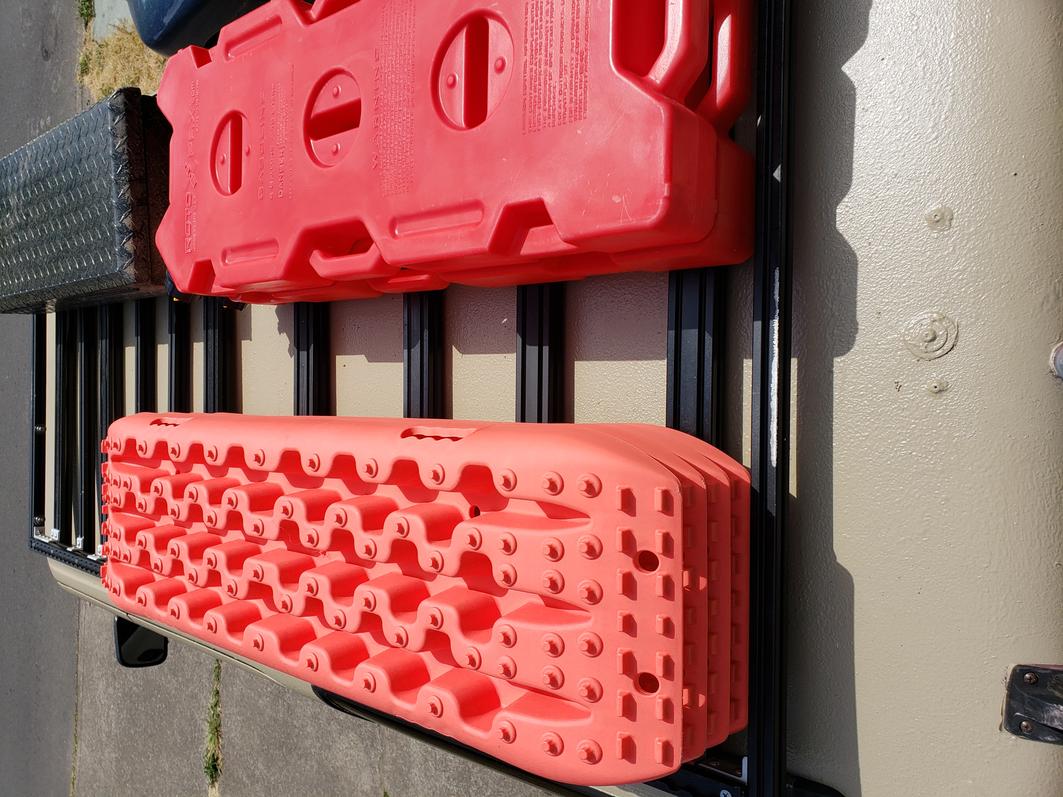

I have a couple of sets of the X-Bulls that my kids got me for fathers day
My only real gripe about them is they don't stack as well as the big bucks sets. If they keep me from having to pull the rope from the winch to go a couple of feet than the trade off will be worth it.
I don't drive around with them on the rack all the time. When they are up there I don't notice any extra noise

The 4 xbulls are layered and that doesnt look bad. I may get another pair.

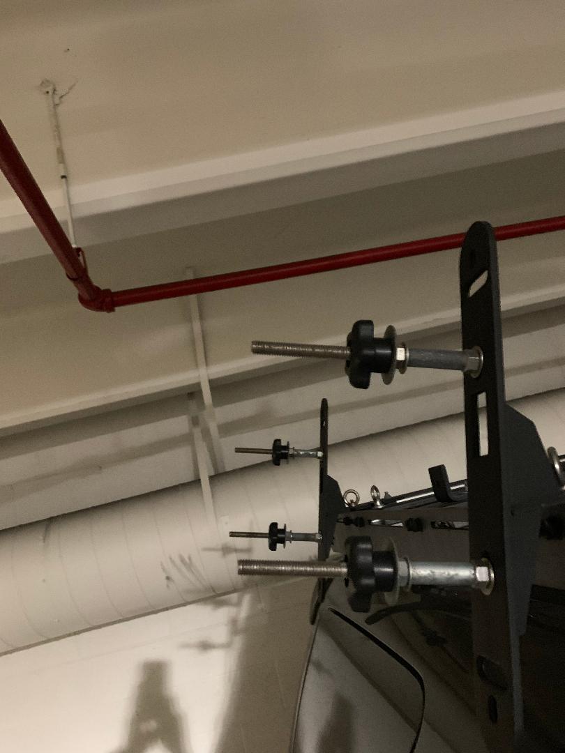

How I mounted mine to the roof rack are as follows x 4, in this exact order:
1 long carriage bolts
2 wide washers and 2 bolts to lock the carriage bolts to the rack
1 stainless steel standoffs that sit on the carriage bolts to keep the boards from vibrating or moving (can use electrical tape or rubber tubing).
1 nut that acts as a stop for the standoff
1 big washer to tighten the board down
1 more nut w/ plastic knob or 1 wing nut.
2 pistol locks (cable locks) to secure it from thieves.
you can find all of the above at home depot or ace hardware except for the: plastic knob w/ nut insert and the stainless standoffs, and the pistol locks (you can buy them at your sporting good store for all u non-pistol owning enthusiasts0
got a photo of this mount setup?
Here you go. This is the same setup I had on my roof rack before I stuck it on the rhino mounts.
Currently, its pretty dirty. It looks like rust, but it isn't....its just baked on dirt.

What mounts are you using? I'm looking into getting a pair of x-bulls and doing something similar.
