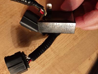

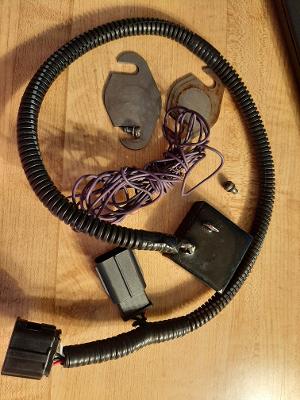

Babe.....do you know what bypass you had in the truck? My guess it was original Hewitt Tech version(lots of wiring). I haven't heard of many bypass issues as they are pretty simple devices. Let me know how it all turns out. I'm sure you're not wanting to install another but there are many forum members on here running my bypass with no issues what-so-ever. All of those codes you listed are easily defeated with a properly installed bypass.

I'm attaching 2 photos. What can you tell me about what you see?

This only happened when cold and it started again this year so I finally got around to installing the blockoff plates the other week. Seems to have solved the problem. If any future searchers are borderline on needing the plates and debating install I can only say do it while you still can, one nut on the driver's side is a real PITA when it starts to rust, almost stripped it. Mapp torch with a hose quenched with lube right after will make your life easier. Plus a medium-deep socket, sharp angle swivel and bunch of extensions. The kit itself is quality all around at a good price though :thumb:
