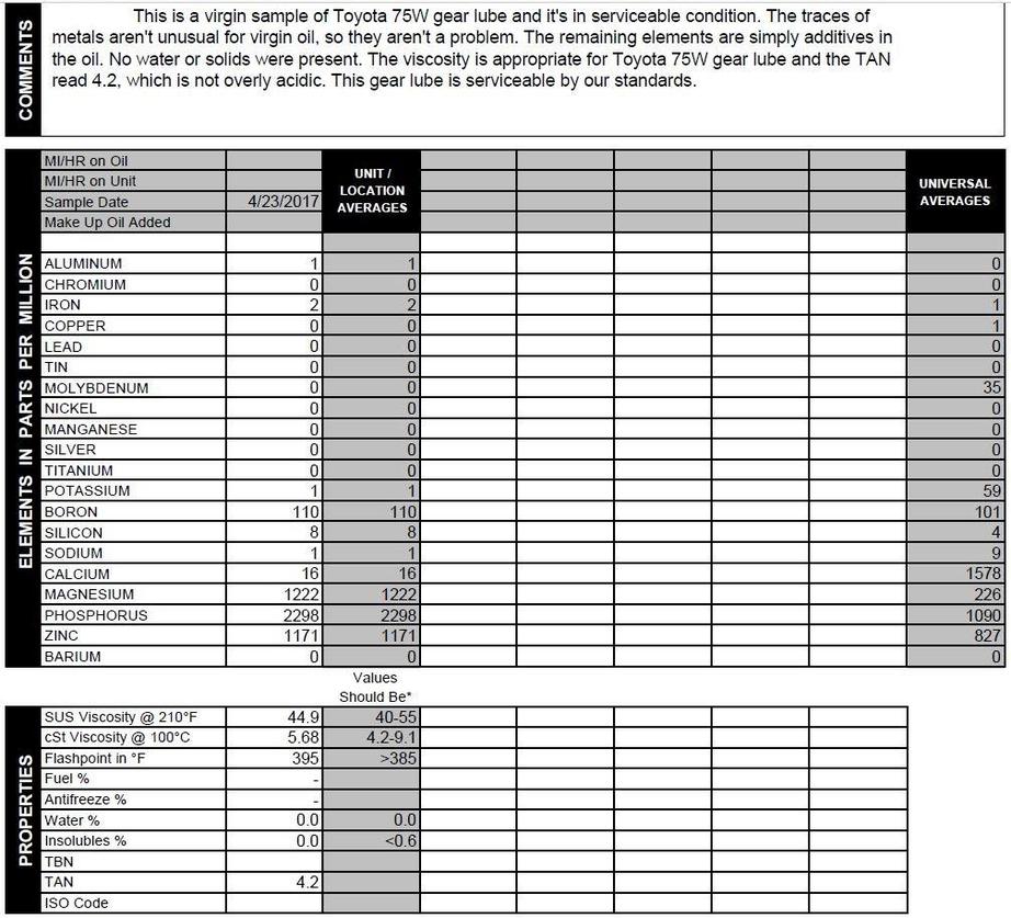

this is why you should use the toyota transfer case gear oil/fluid.. viscosity not the issue it is the additives in that toyota fluid ..

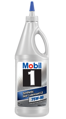

So just to be clear, this stuff is fine for the front and rear differentials?

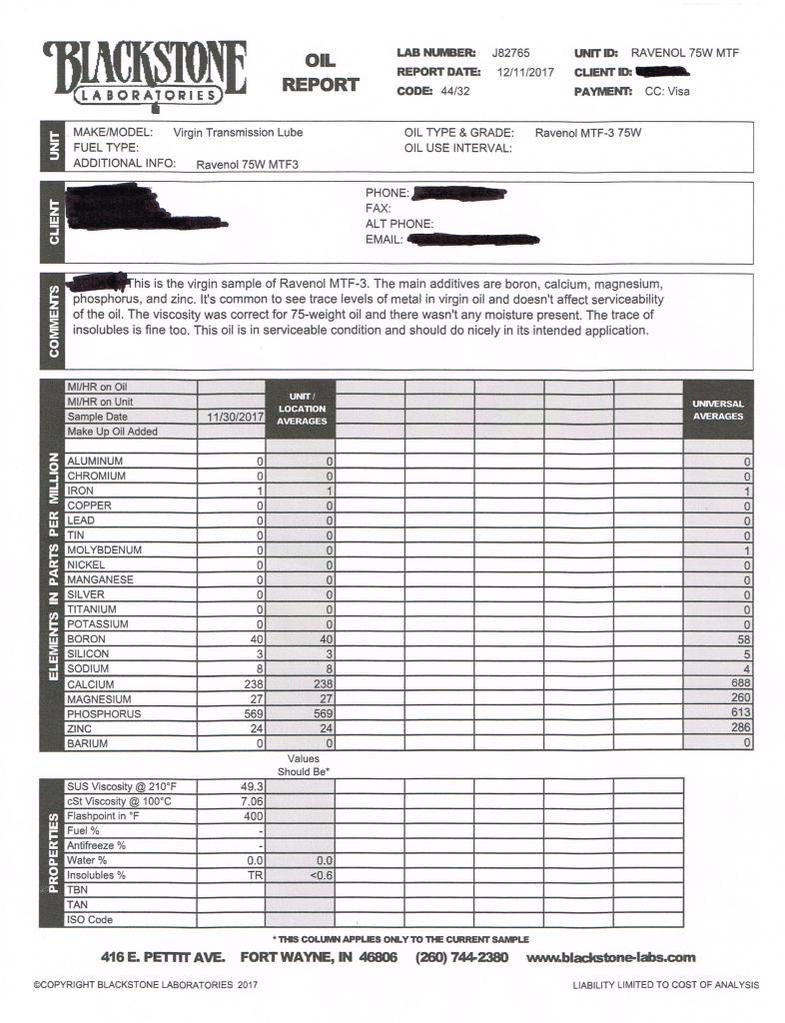

this is the ravenol 75wt oil .. see how little additives it has .. same 75wt but not the transfer case protection from wear.
Yes, this is what a lot of people use. If you want a "closer to spec" replacement, try the Redlne 75w85 gear oil.
