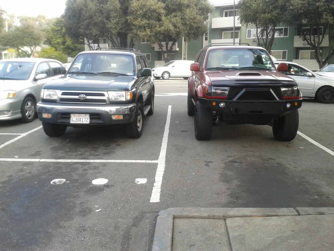

Took this to show where my lift is at, my tires go on soon so it should add another 3-5 inches of height.
thanks man,
Yeah my current tire height is 29'' and I plan on getting either 34's or 35's so yeah theres the math
35"s is the diameter. So the difference between your current tire and the new tire divided by two is how much it will lift your car off the ground.
So 35-29= 6 divided by 2 is 3. So at most it will lift your car 3 inches.
