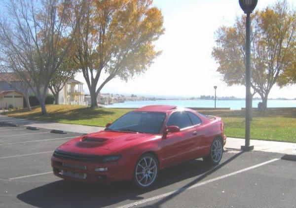

So, after 6 long years I couldn't fight the urge any more. The perfect deal on a great Alltrac came up and I jumped on it. I picked up this beautifully maintained car with only 122k miles on it. I set out with completing the restoration where the previous owner let off and decided to do another RC conversion while trying to maintain it as a reliable mostly stock daily driver. Since then I have swapped in a JDM RC Engine and Tranny. I bought a ViS RC/CS hood, JDM corner lights. I still had a RC badge set and some other HKS parts lying around all these years. I also picked up an RC intercooler here on the board and paired it with a bosch cobra water pump and a front mount W2A heat exchanger. I purchased a Momo 4 spoke steering wheel like the ones in the RC and a Momo Anatomic leather shift knob. The car runs almost perfect and looks pretty good.

Current Ride:
