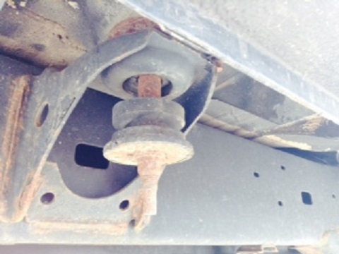

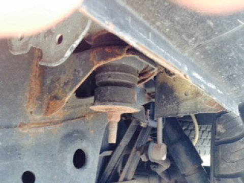

I read from another member that on the 96 models the center body mount bracket isnt even on the frame. So Toyota added it to 97 + models. But they are all the same in having a gap between the rubber bushing and frame mount, making them functionally pointless. So Im wondering a few things . . .
- Why would Toyota add the center body mount bracket and then decided not to use it? Maybe it was used on the Taco which shares the same basic frame as 3rd gen?
- Why put a partial bushing that doesnt even fill the gap between body mount (as pictured below)? Maybe to provide more flex between body and frame?
- And has anyone added a full length bushing to the center body mount, and found it to make any difference in ride quality?
8 of the 10 body mounts on our trucks look like this.
And then the two center body mounts have the gap.

There is a reason why the middle body mounts have a gap there. Toyota wasn't just lazy and forgot to add the bottom bushing.
I vaguely remember reading that the reason for it was crash related. I'll post it up if i find the actual reason.
I would be interested in seeing that
I searched the sticky and did not see the thread. Can you post the link you are referring to?
I am ha kng trouble finding replacement bushings that don't come with BL hardware.
Have you ever looked at them while the suspension was flexed, that is the reason, the gap allows the frame to flex separately from the body.
