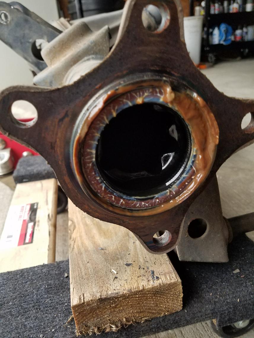

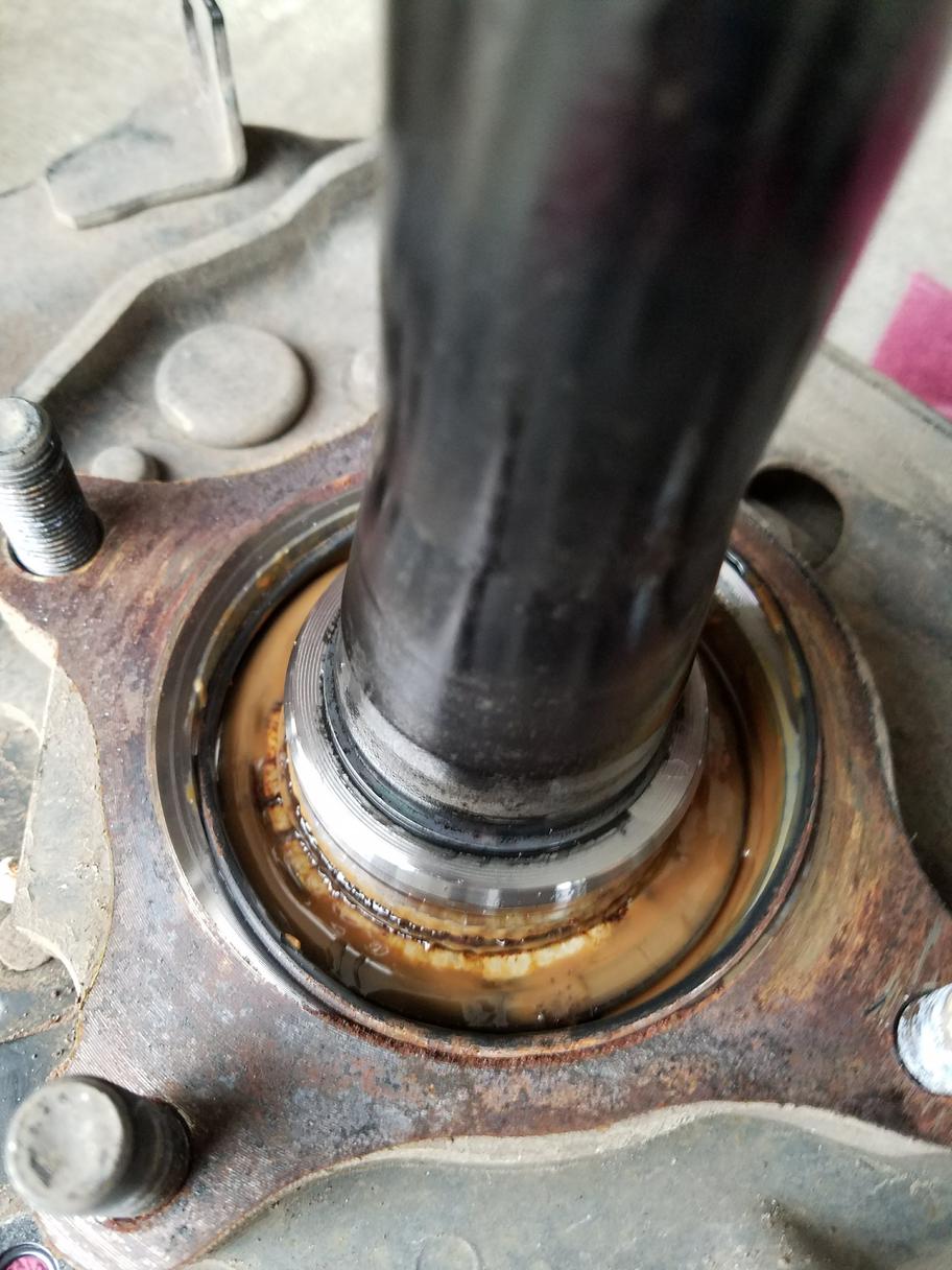

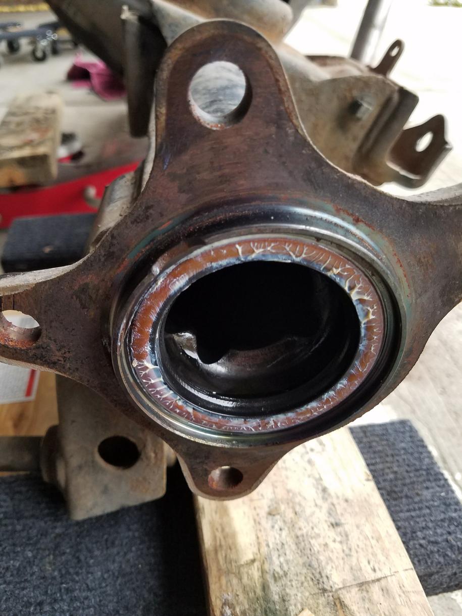

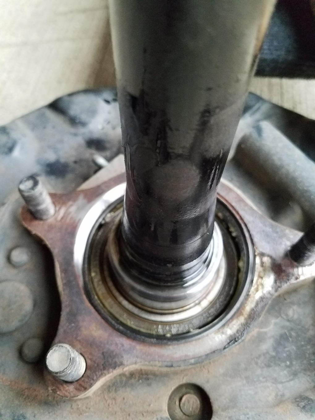

Well....tore apart the rear axles. The drivers side looks A-OK and the bearing feels great. Passenger side, well...looks like a leak from the gasket as it looks like the grease has mixed with the diff fluid. However it wasn't leaking on the brakes or hub or anything like that. The bearing feels good, but my worry is seepage into the bearing even if they are sealed. They are sealed right? I was hoping to have my new bearings by tomorrow so I could take the axles with me to Sacramento and have them pressed on there as the labor rates are quite a bit cheaper than the Bay Area. But nope.

Crow bar and a 5lb sledge for the front axles usually does it. Definitely looks like a leak there. One of mine looks like that. Shit I should probably do it while I have the 3rd member pulled, I just didn't want to hassle with the brakes.

Yeah...I think I'm just going to bite the bullet and do them even tho the bearings feel great. 180K and me adding full steel armor, sliders, RTT, rear bumper, front bumper, drawer system, etc will put some stress on them I'm sure so may as well go new. Just hope these Timken ones on Amazon will last.

You have to disconnect the brake lines to get the axle shaft out in order to change bearings and seals. You also have to disconnect the e-brake cable, which means disassembling the e-brake setup as well.
The wheel bearings are sealed, however, fluids can seep into them. After I changed my front wheel bearings, I went to press the old ones out of the hubs and wound up cracking them apart at the races. There was an orange/brown color goop all over which I took to be some rust mixed with the grease. I'm fairly sure water intrusion killed my bearings. Maybe the prior owner took it wheeling a little, who knows. It was i good shape and came from Az. Anyway, they are sealed but not impervious.
