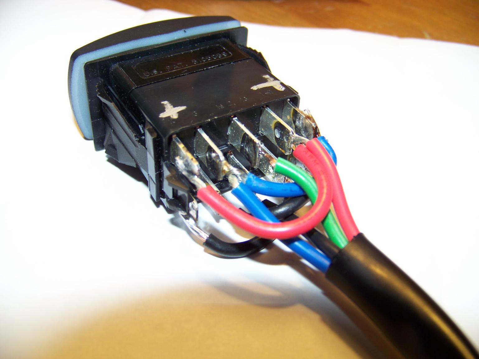

Cant tell in that photo but the bezel is a few mm off the console because I have yet to cut back that plastic piece. I also had to bend one of the protruding connectors on the back of the far left switch to clear a bolt. Going to be fun trying to connect that one up.
Solder them on and then cover the connections with liquid electrical tape, that's what I did. Never have to worry about it!
