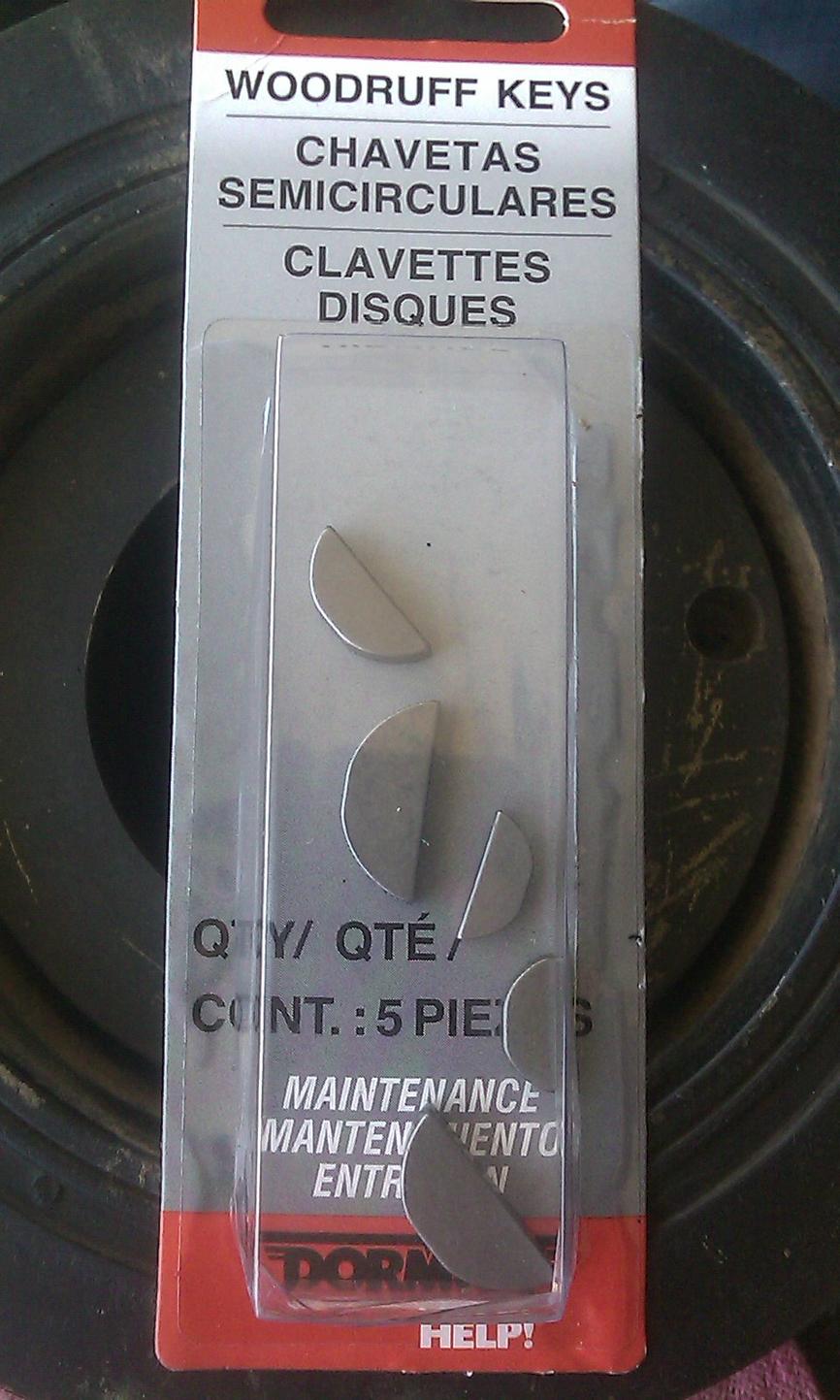

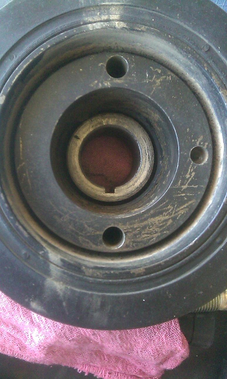

I went to Autozone to borrow their harmonic balancer installer (free rental btw). They told me to be very careful installing and make sure the woodruff key doesn't fall out. This supposedly fits betwen the inside barrel of the cs pulley and the bolt. But when I pulled the pulley there wasn't a woodruff key in there.
Was autozone wrong? Is there not a woodruff key in there? If there was, I haven't seen a single write up on resinstallation that included any comments. I've attached pictures to help explain.

Just about to type the same thing. Bet the key is still on the crankshaft. And they are correct about it. Without the key the pulley will chew up the crankshaft - then it's new engine time or a serious rebuild
Yeah, 90% of the key is under the crank gear that drives the timing belt. Only about a 1/4" extends under the pulley. So it's still there if you have not removed the gear.
Thanks everyone. After finding it, I felt like an idiot for asking the question.
