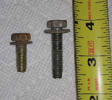

My question is this: I have 12 bolts (obviously) - 6 bolts about 3" long, and 6 more about 2" long (I don't have them in view right now, and those lengths are approximate). Can anyone tell me which screws go where? I'm assuming 3 short and 3 long for each side. But where exactly should they be installed?

I wound up placing the longer bolts in the outboard holes, and the shorter ones in the inboard holes.
The odd thing is, several here have said their rb bolts were the same size. Mine (original) AND the bolts I got with the running boards I bought second hand, were different sizes. I unintentionally overestimated the bolt lengths in the first post, however, they are two different sizes on mine, and the other guy's runner.
I still have my original boards (and bolts), which I'm saving for maybe a paint, undercoat, or plastidip project.
