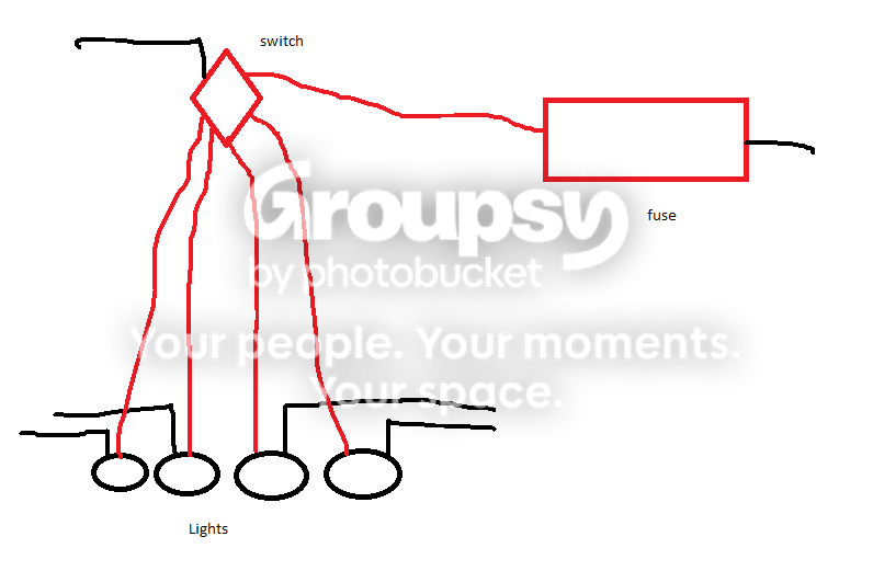

ok so if I wanted to do this in the simplest way possible, Would i be able to go from the negative on the lights to ground, positive on the lights to switch, positive on switch to a fuse, and negative on switch to ground? All I have are 4 pods so I don't think that's enough power to need a relay.
lightwiringdiagram_zps8977fd5a.png~original
Sort of like that?
A switch with 4 + outputs? If it were me I'd probably wire all 4 lights in series and just have a bus bar or something

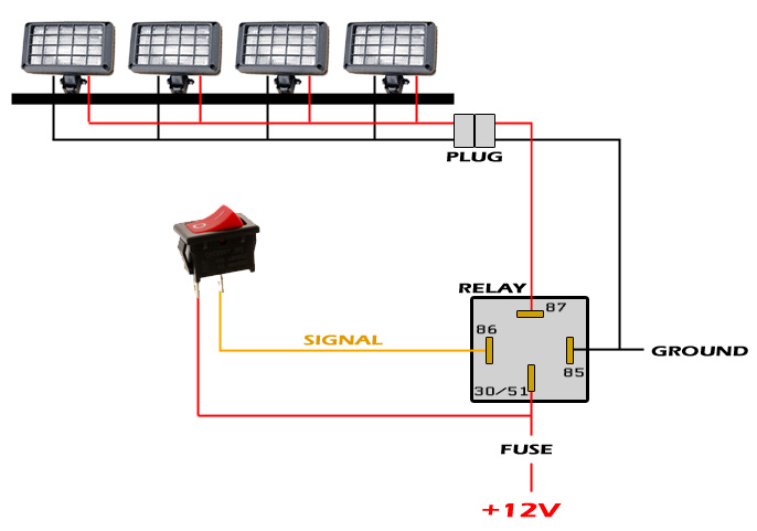

more like this
Why would you want to wire 4 separate pre-built off-road lights in series?
Wire them in parallel like the picture above that way if one fails the other 3 will still light up.
My bad, i meant parallel, it's been a long day :cheers:
It's all good...I've been there many times before.

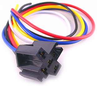

Just get a $3-$5 12V / 30amp / 5 pin relay. You won't need to use the center pin.
http://www.parts-express.com/pe/showdetl.cfm?partnumber=330-073
Also get a relay socket harness to make the wiring nice and neat. They're around $2 or so.
http://www.parts-express.com/pe/showdetl.cfm?partnumber=330-075

more like this
i know this response is old but lot easier way.
-only one wire to lights
-no load groung thru switch
-one wire coming from relay
-easier to find a ground near switch
-only 3 wires going to relay vs 4
