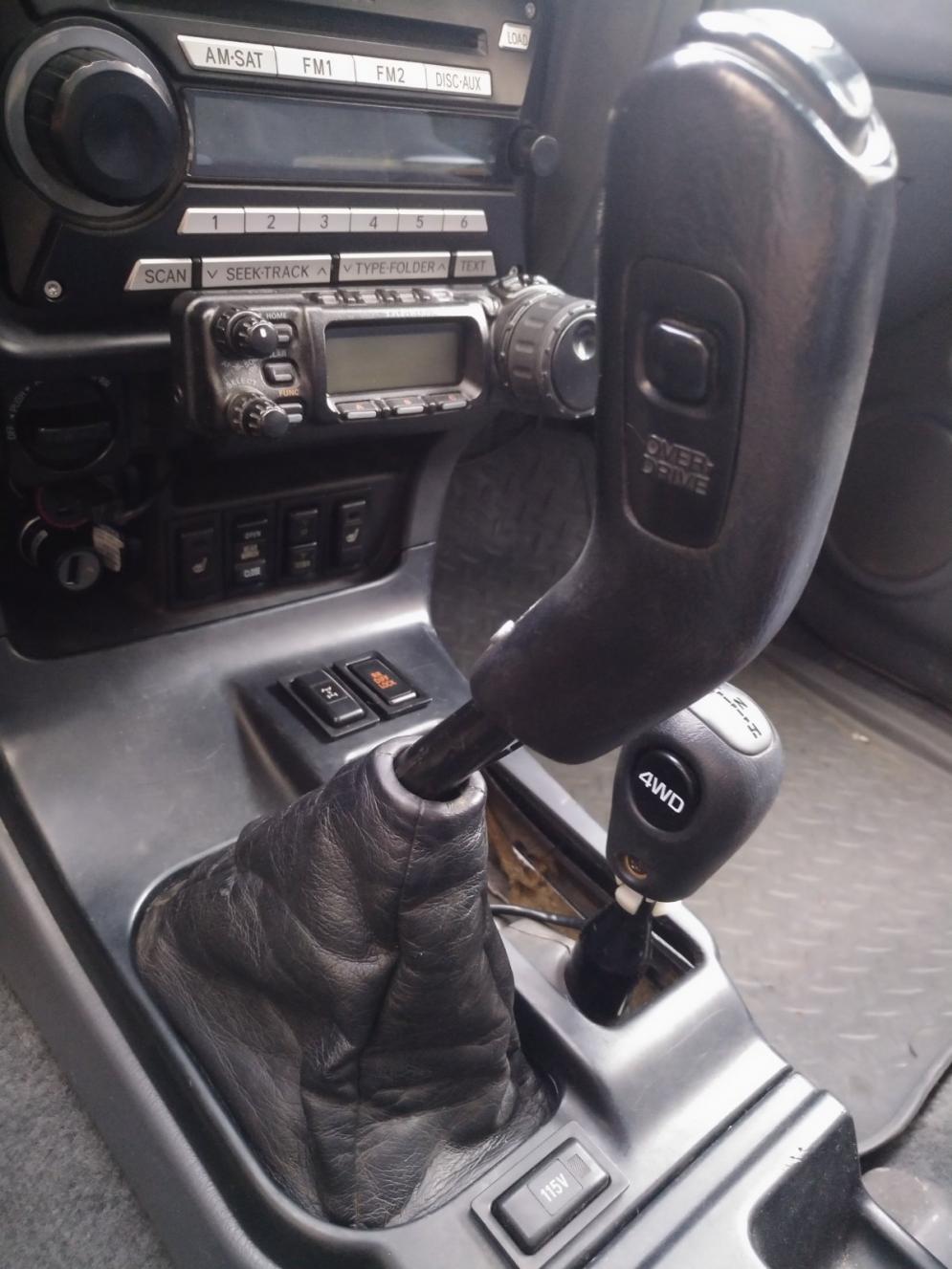

Or what you can do is move all your 4x4 switches in one place with the 4x4 lever...
