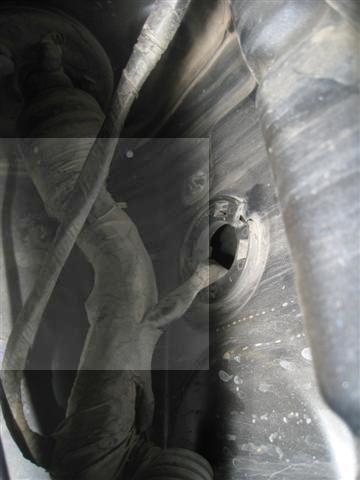

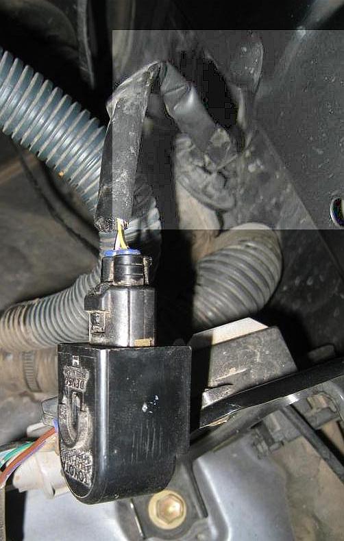

I took mine out got tired being n the parking lot everyone with them being cool . Its actually n the inside of fender well by the brake booster , lil bit of a ***** to get to but you have to pull the plug out of there .

I noticed a wire that goes into the fender near the booster. Is that it? Why does it sound louder under the hood than it does outside by the wheel, is it muffled somehow?
That's it. Straight down from the bottom of the hood strut. That flange will come off pretty easily and make it easier to get to. I presume one reason it's louder under the hood is because of the hole and the echo.

Had a PM request for pics. Gonna post em here.
