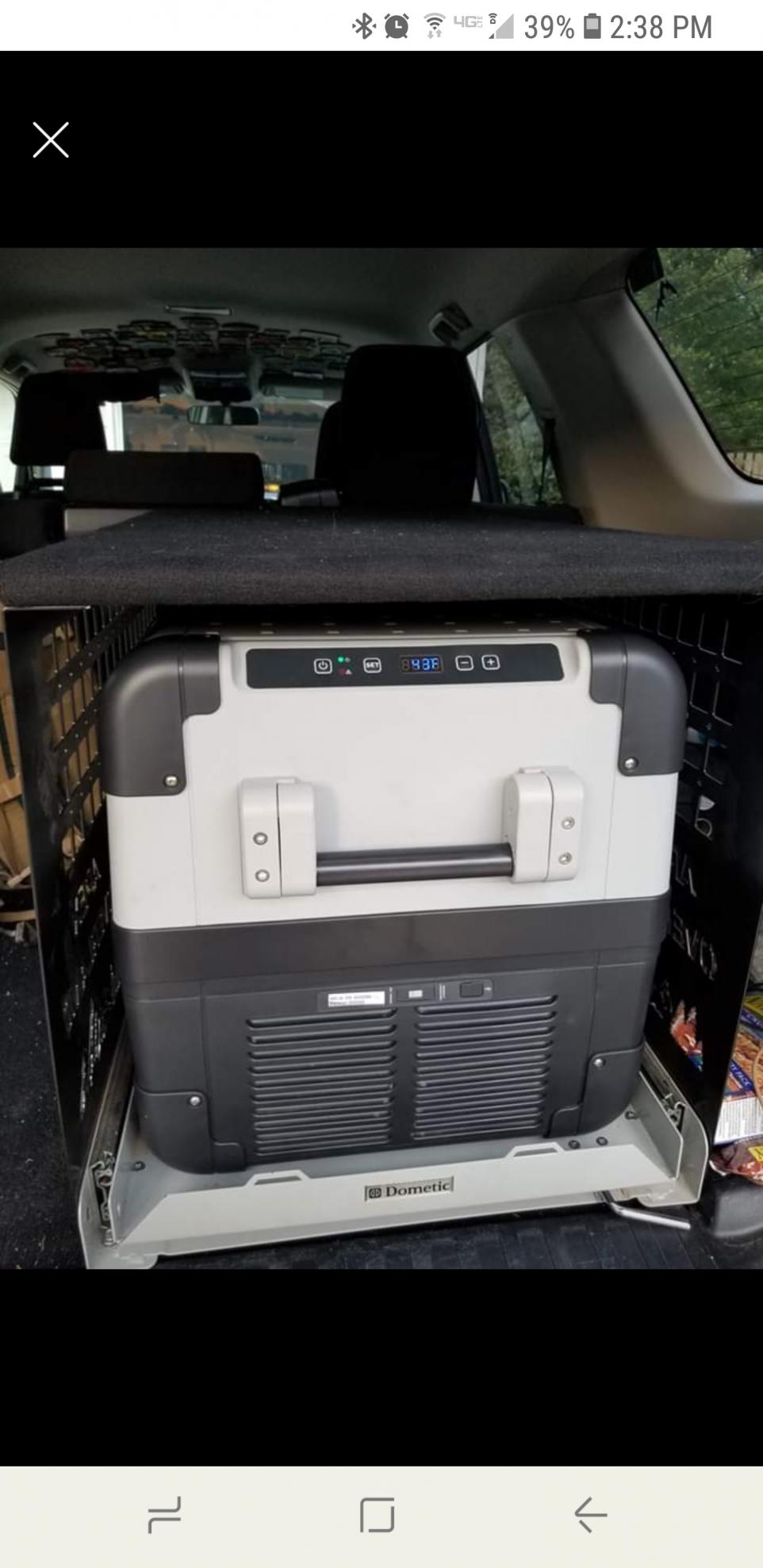

I have a molle surround I am going to use. One of the local shops built it. Trying to attach picture from my phone, well see if it works. Its molle panels on the side and a hard top to put stuff on.

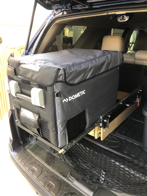

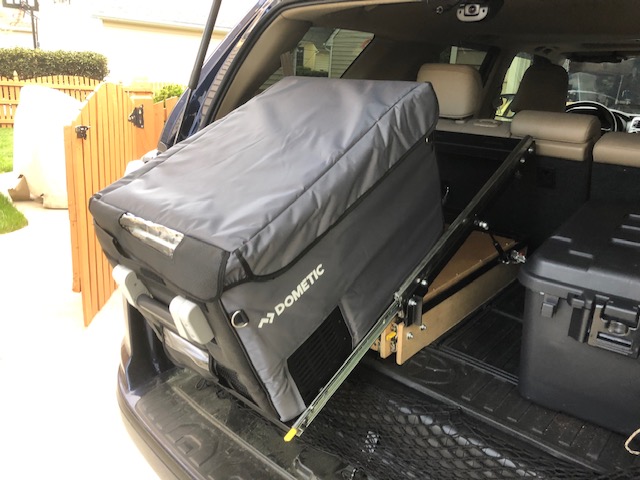

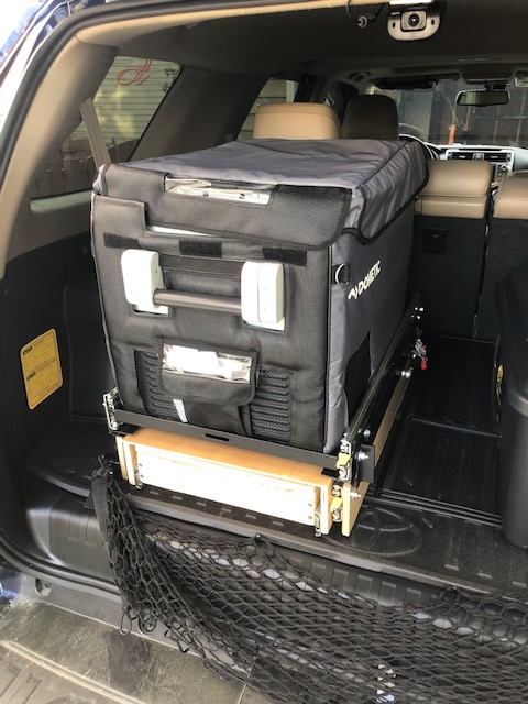

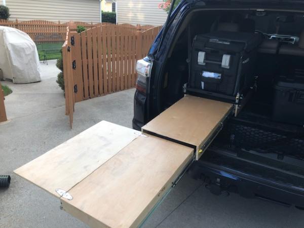

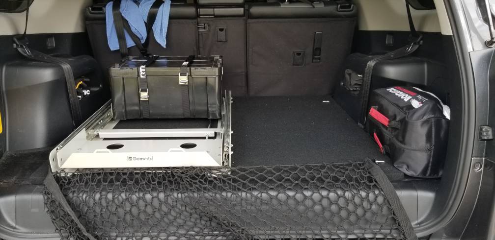

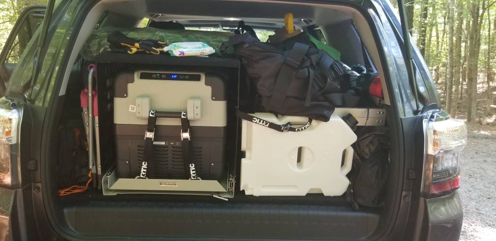

I made a custom setup having a fridge slide with tilt, small slide out table and drawer with fold out table lid. I am using the two factory tie downs on passenger side and the LATCH anchor point on the back of the 2nd row passenger seat. All can be removed to use the 3rd row.
Do you have photos anywhere???

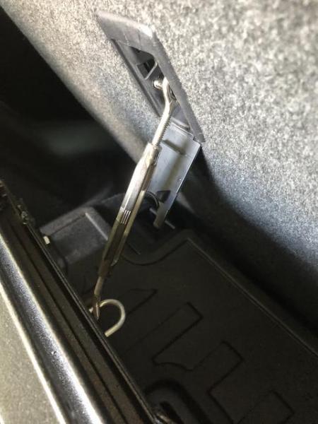

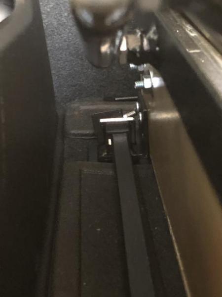

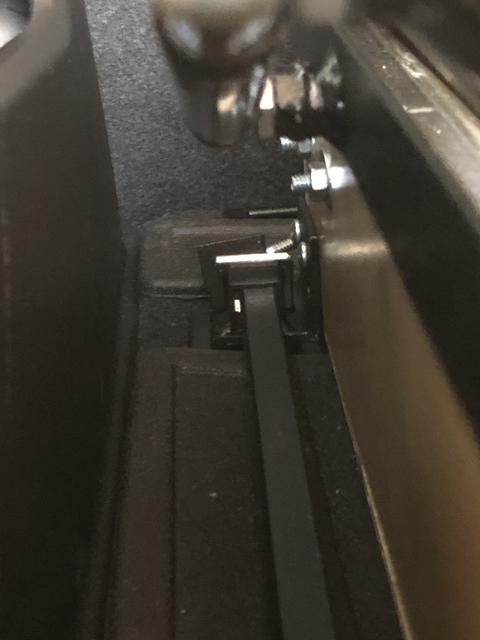

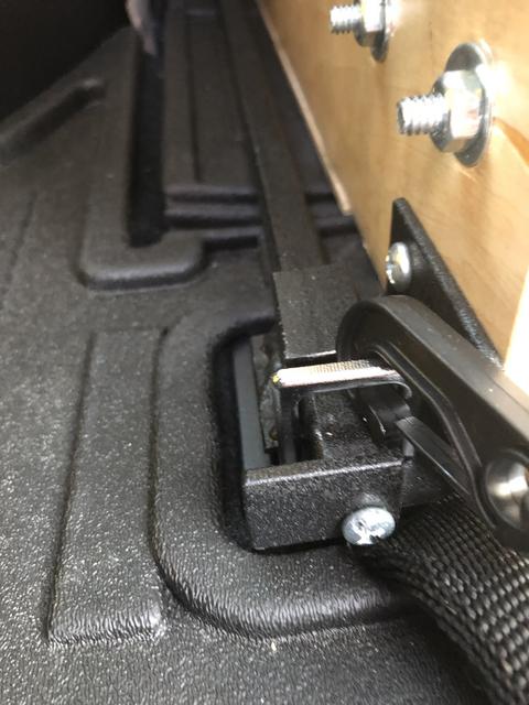

I used a single piece of ½” square steel tubing to slide through the 2 attachment points in the floor. The tubing also slides through 2 pieces of ¾” square tubing attached to the slide assembly. This holds the slide assembly in place. I also have a turnbuckle at the rear that engages the LATCH on back of seat. It sits on the drivers side and still allows me to use the passenger side 3rd row seat without removing it. Not as sturdy as installs without 3rd row, but so far no issues with the assembly moving when sliding out the fridge, but only used handful of times. And the fridge is Dometic CFX 35w.
Thanks for the info, although the pictures didnt seem to work and I cant track them down in the photo album section.......
