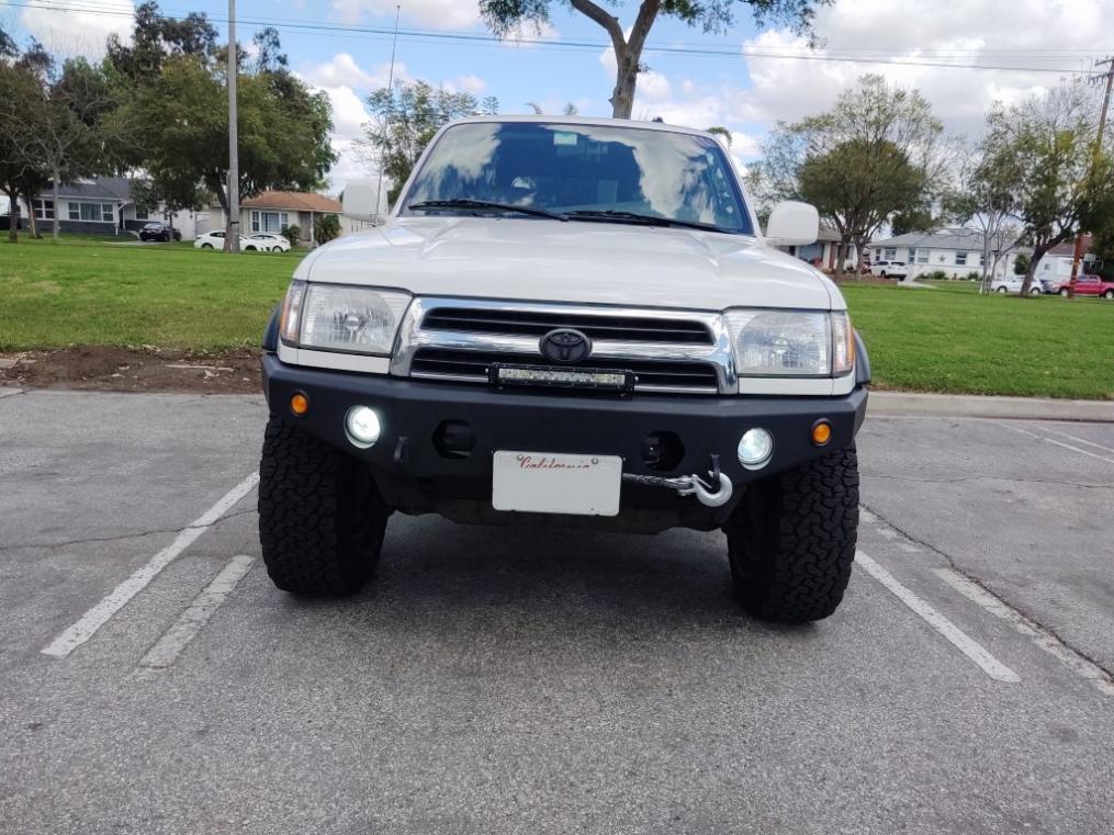

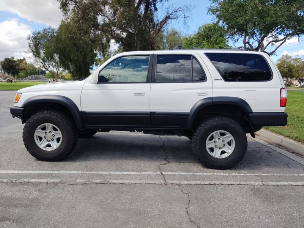

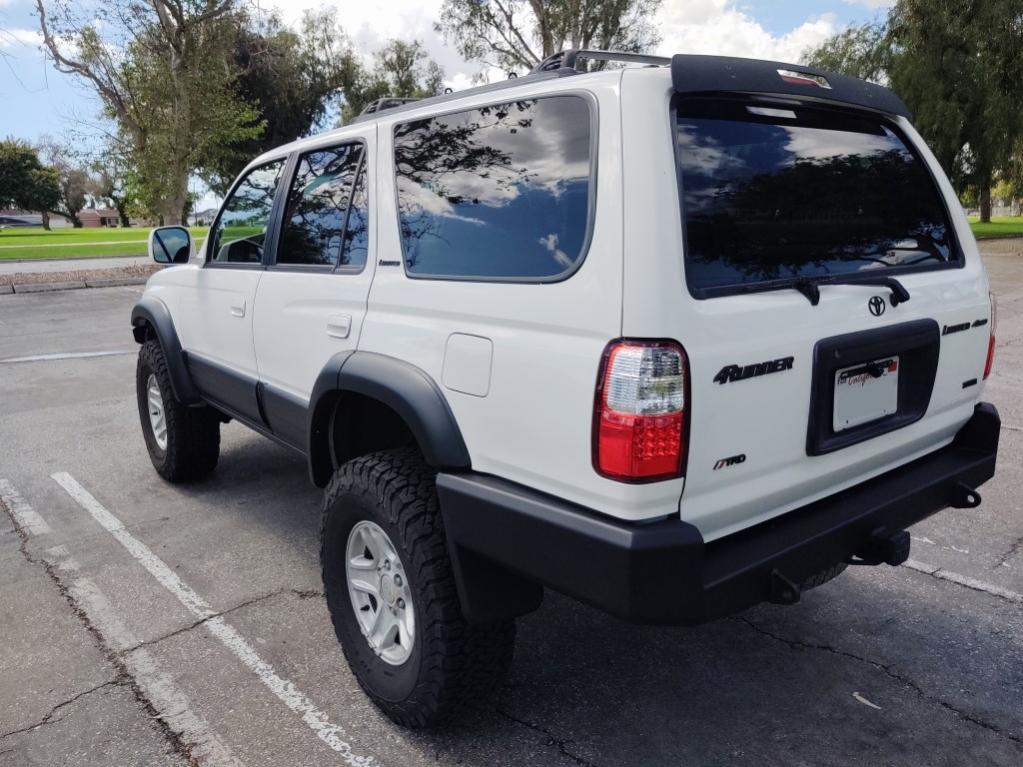

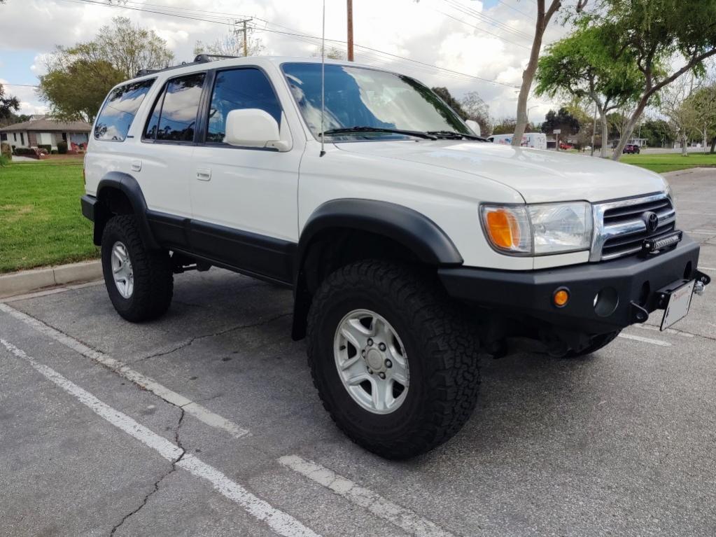

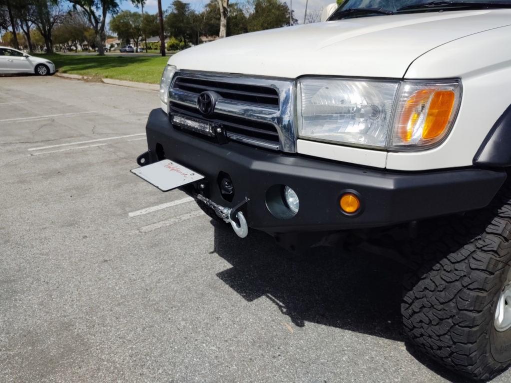

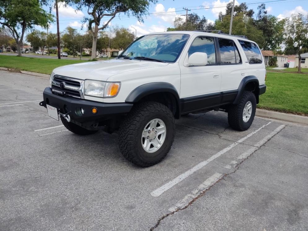

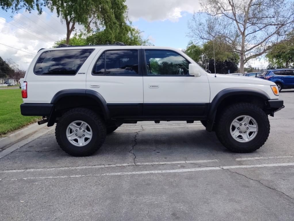

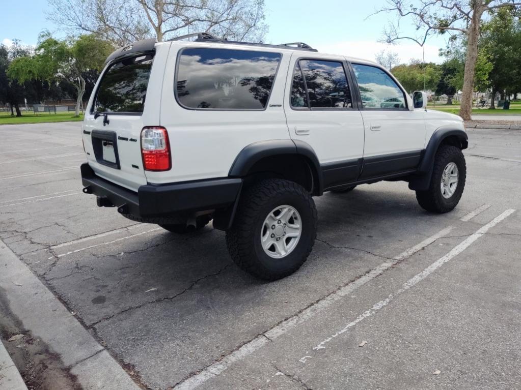

Thought I'd give everyone an update. So I decided to Matte Black spray the bumpers. Vinyl wrap would have just been too complicated and I realized I could easily spray them the cladding color down the road anyway.
I did Wrap the cladding, mostly to see if I liked Flat Black and I have to say, I'm not disliking it at all!
I'm going to get angled sliders, but that will probably be another 4 months before the arrive.
The next question is do I spray the wheels also a black color, or recondition them to the original silver?
Modifications so far: 4x Front/Rear bumpers, Warn 12lbs winch with Syn line, Halo/LED driving lights, LED light Bar, Flip up license plate holder for hawse fairlead.

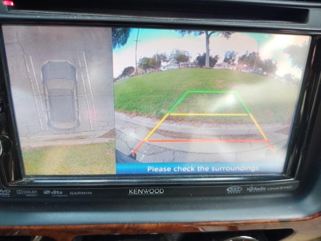

OH, I also managed to add a Birdeye View Rear Cam system :)

Thanks for the update, I really like the look. What did you use for wrapping the cladding (if you have a specific link)?
Thanks. It's not perfect, but very good (the job I did, the Wrap itself is pretty awesome and forgiving). Also I like the wrap idea since if I get bad desert pinstriping, I can just replace that section.
I used this:
Amazon.com: VViViD Satin Flat Matte Stealth Jet Black 5ft x 25ft 125sq ft Cast Vinyl Decal Bubble-Free Car Wrap Interior: Automotive
