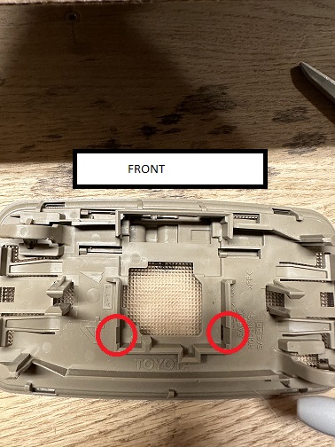

Thanks for the pics and info! I'm in the same boat... I accidentally broke one of the corner clips because I forgot that I could pop the lens out, instead of the whole dome light housing. So now the housing doesn't stay in the headliner, the broken clip causes it to drop down eventually. I'm going to order a replacement housing + lens... but have you figured out how to remove/disconnect the end of the wiring harness/bulb socket from the dome housing? I'm tempted to use a pry tool to pop it out, but I'm afraid of damaging something and then having a bigger problem on my hands with the wiring harness not snapping into a new housing properly.
I thought of this thread because I went to replace the housing. it is actually very simple to remove the housing from the harness. in the picture below there are two spots where you can insert a pry tool and GENTLY pop each side out. took me about 10 seconds total to remove the housing
as the poster above mentioned be careful because if you mess up that wiring harness you're screwed. the entire metal piece that is in there pops out and pops into the new housing, lightbulb and all. the Front represents forwards direction. so if you pull the housing down the front is where the toggle switch is
edit: the sand beige housing is 81240-42020-E0
