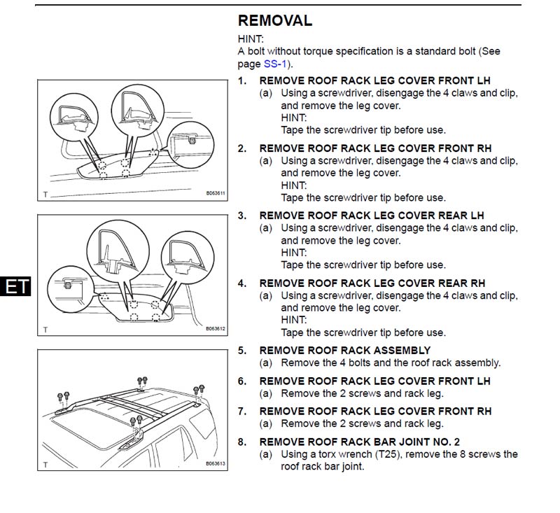

You need to remove the rear end caps/covers on the bars that run fore/aft. I haven't seen the specific directions on how to remove them for the tubular rack on the SE and Urban. For the regular rack on the SR5, pre-2005 SE and Limited, it was a bit of finess and prying the bottom of the caps just enough to pull them off.
here is a JPG from the PDF

thank you r32!
the sport looks a little different from what i have seen under the caps. if i tackle this i will for sure post some pictures!
