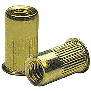

Use Nutserts/rivetnut, find the exact size
