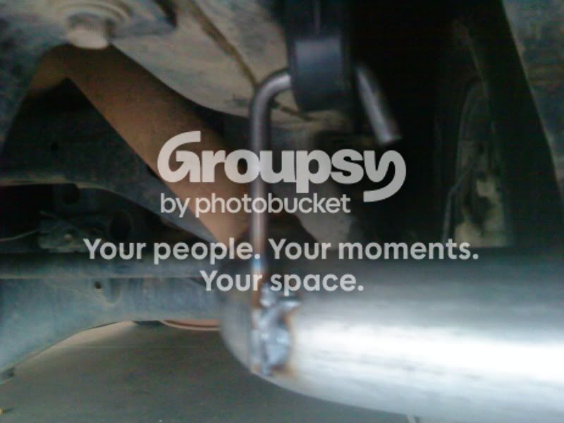

After banging my resonator and tail pipe one too many times while wheel'n, I took ric's advice and scrapped my resonator. I went ahead and had the exhaust rerouted out of the side at the same time and had a new exhaust tip installed.
So, why did I post this in the off-roading section rather than the exhaust and performance zone??? Well, removing the resonator doesn't add any HP and really didn't change the exhaust note, so I don't consider it a "performance" mod. However, this is a much more practical off-roading mod, especially with the crap departure angle on the 4th gen 4R. Total cost was about $150 for parts and labor. Below are a couple of pictures of the new product and the old resonator.
Old resonator. It's hard to see in the pics, but you can see where I dented and scraped it 4-wheel'n.
DSC00018.jpg~original

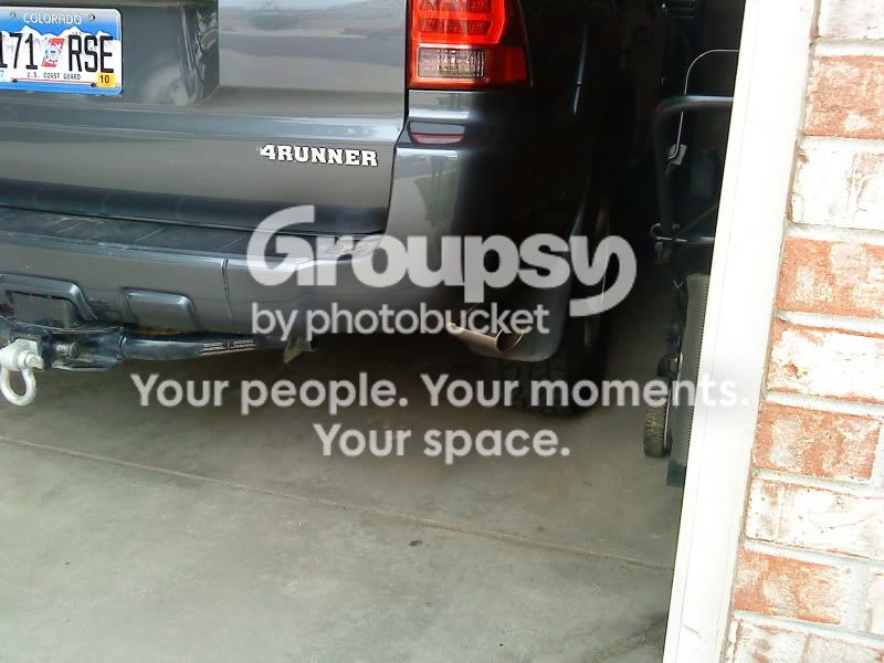

New side outlet and exhaust tip.
DSC00019.jpg~original

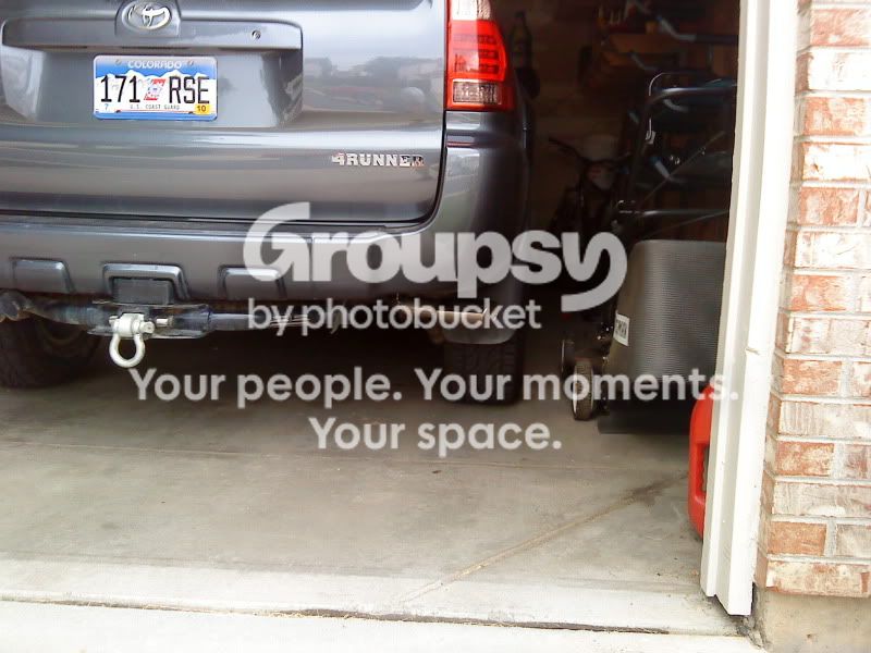

DSC00020.jpg~original
The other benefit of the side outlet exhaust is that it has cut down on the sulfur smell significantly. It didn't eliminate it all together, but from what I can tell so far, it has helped quite a bit.
that looks pretty bad ass coming out the side like that. do you have any pics of the rear a little further away so we can take it all in?
I bent mine the first time I offroaded and did that too and love it. If you make the angle a 90 deg it will be even less exhaust smell.
Looks good. Couple of questions:
What type of tip is that?
Is it stainless steel?
Did you (or they) weld the new pipe to the cut off section of the pipe, or did you just use clamps?
You said it sounds pretty much the same. What difference did you notice in sound?
Below are the answers to your questions. Let me know if you have anymore. :)
What type of tip is that? I don't know the brand, but it is about the same diameter as the Valor exhaust tip that I replaced and you see on a lot of 4R's. It is an oval shape (rather than round like the Valor) and it is a weld-on tip.
Is it stainless steel? Yes
Did you (or they) weld the new pipe to the cut off section of the pipe, or did you just use clamps?They welded it. It looks like they did a clean, professional job.
You said it sounds pretty much the same. What difference did you notice in sound? Little to none. I think I only noticed a small difference because I was listening for it, but really it doesn't make a difference at all.
