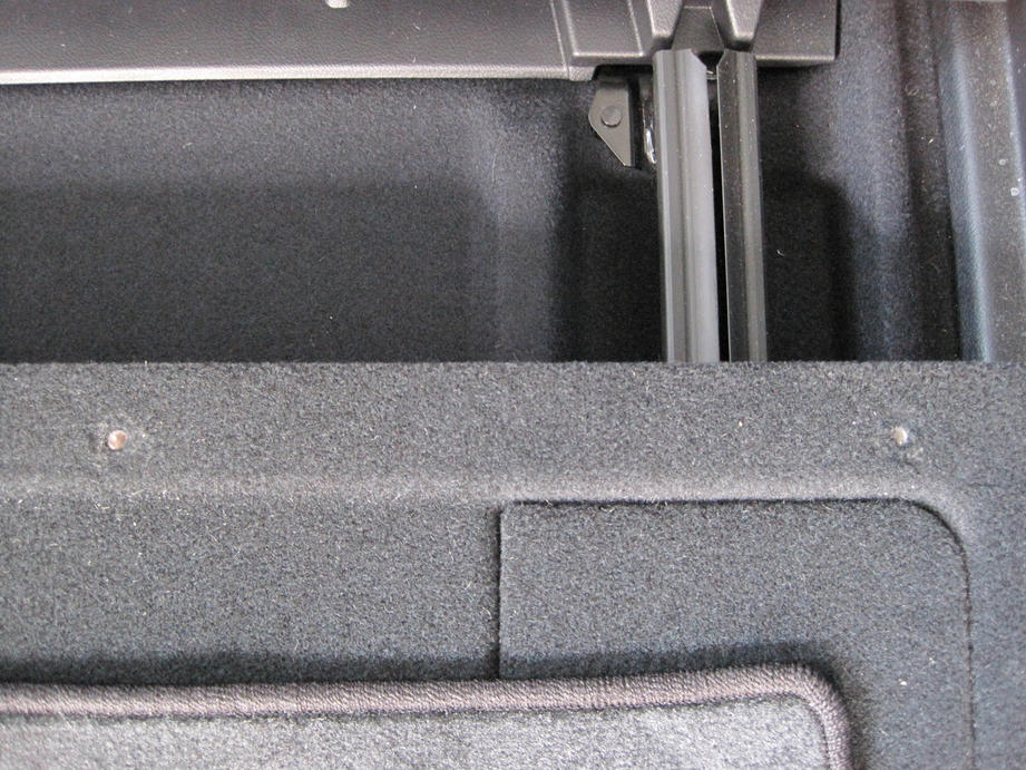

Removed the Stop Bar on the Slideout Tray

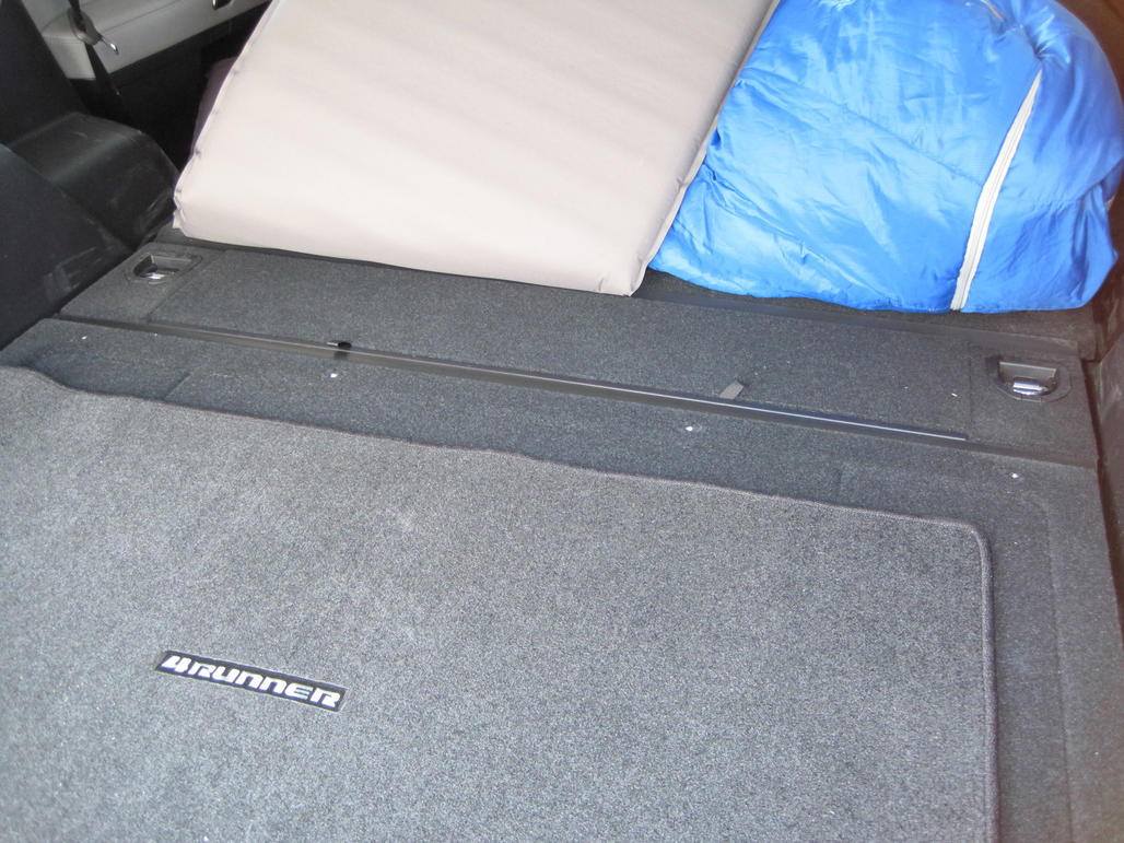

I removed mine shortly after buying the truck. Nuts are under the edge of the tray. Yes, that is my sleeping bag in the bed. For how much this ride costs, I better be able to live in it! :D Divider could easily be put back in. Here are some after-mod pictures:

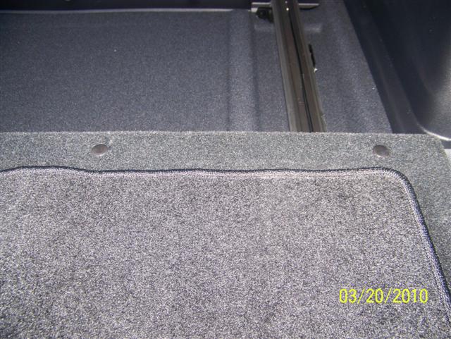

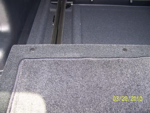

UPDATE:...here is some plugs I had in my misc. bullcrap kit...don't know the size but they worked perfect!

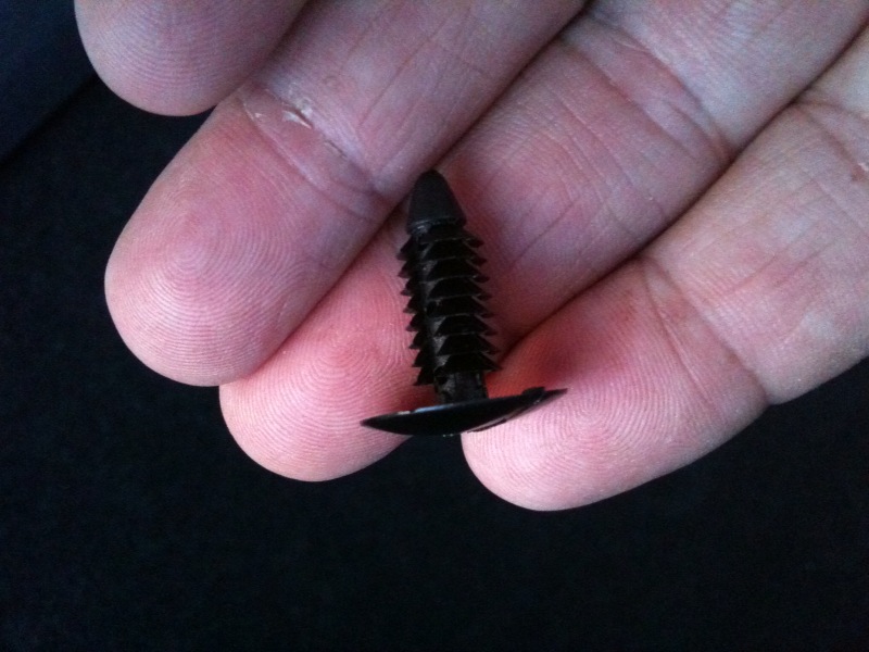

Check out what I found at AutoZone and installed in my TE. They are 1/4" x .7 Panel Retainers. I think it really cleans it up.
I hope that I can get them out if I ever want to put the bar back in.

I got a box of 15 for $4 at AutoZone (fits a GM fender). They worked perfectly and really clean things up. However, the only way I found to remove it was to destroy the top cap and push it all the way through.
I tried prying it up with a flat blade screwdriver; however, I end up braking the plastic top off. And then I was able to push it through and it popped out the bottom.
