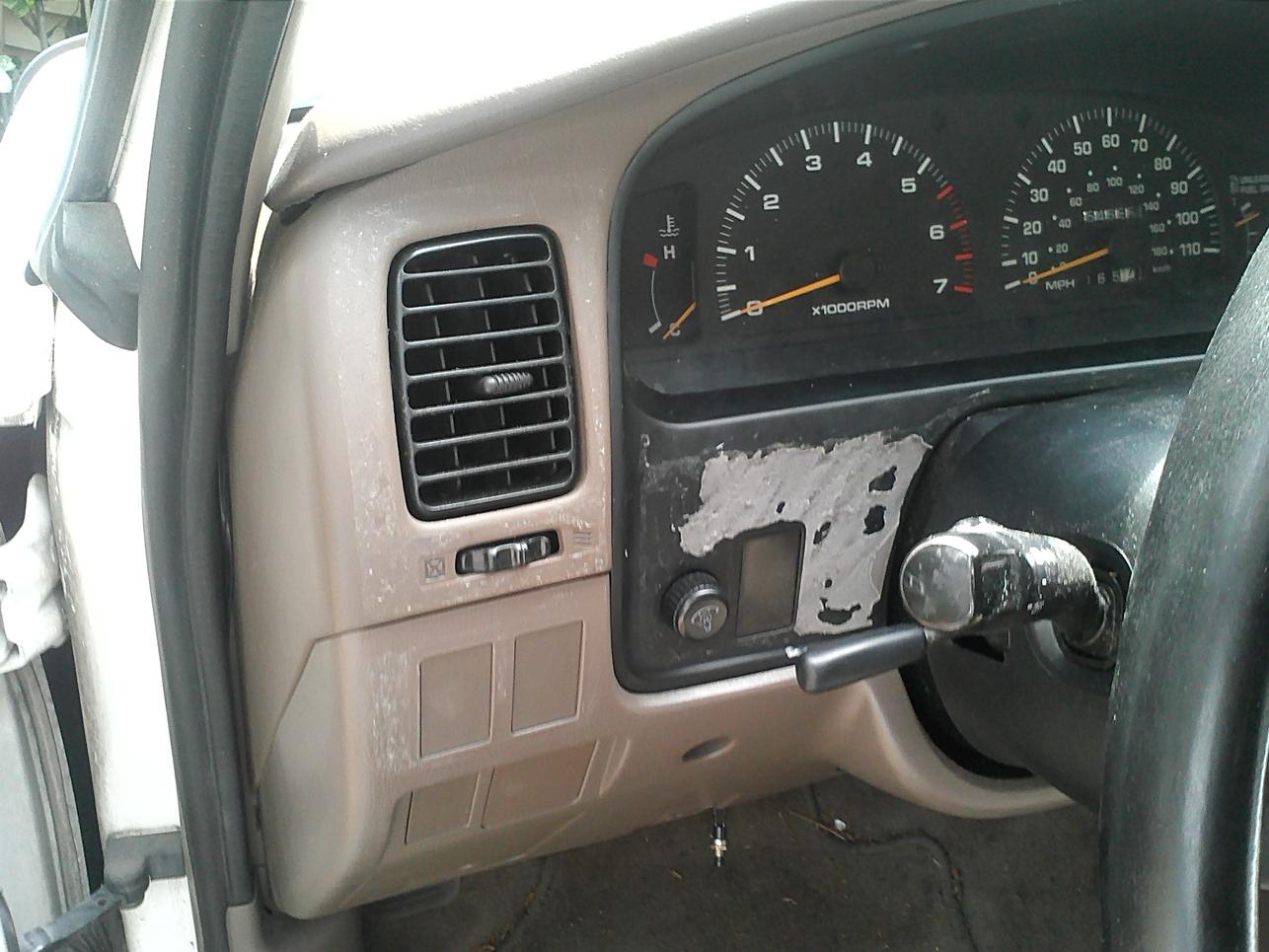

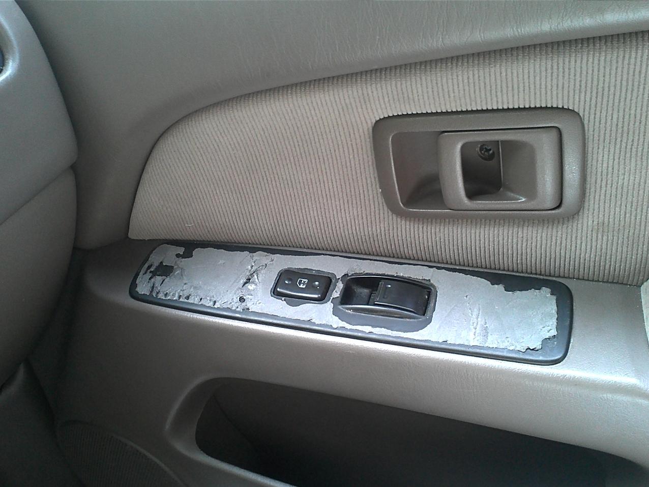

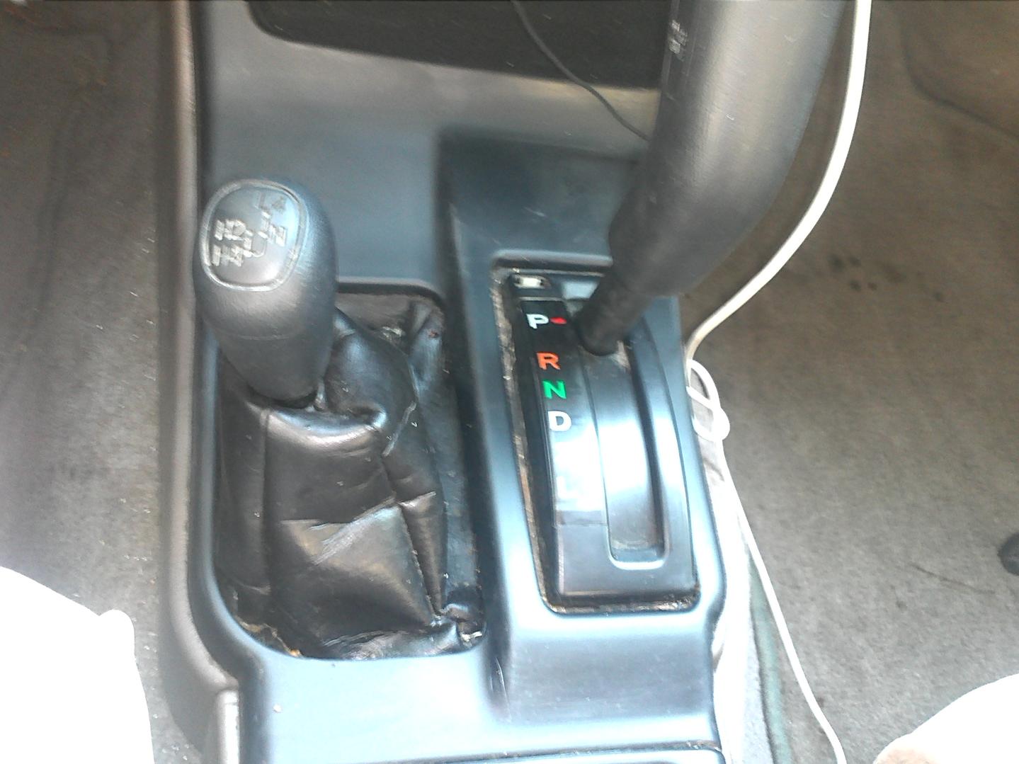

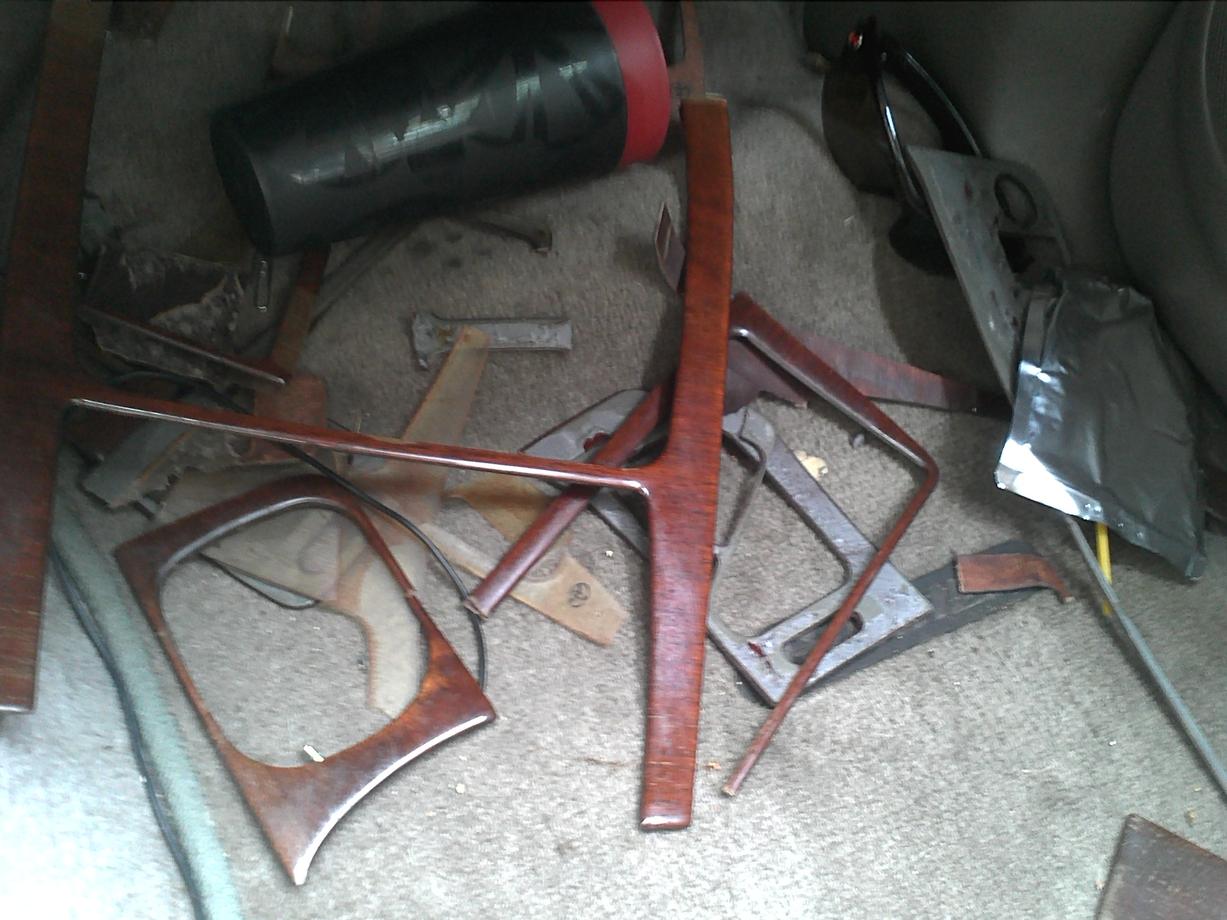

Today I was just reading some other posts on here and saw where someone removed their wood grain. My was/is in bad shape and has been since I had it. Next thing I know is I'm driving down the road peeling it off.It was much easier than I expected. My wife saw me doing it and started to join in. Kinda nice putting the wife to work on the truck without her even knowing it. It is leaving a little residue but nothing some mineral spirits can't clean up.

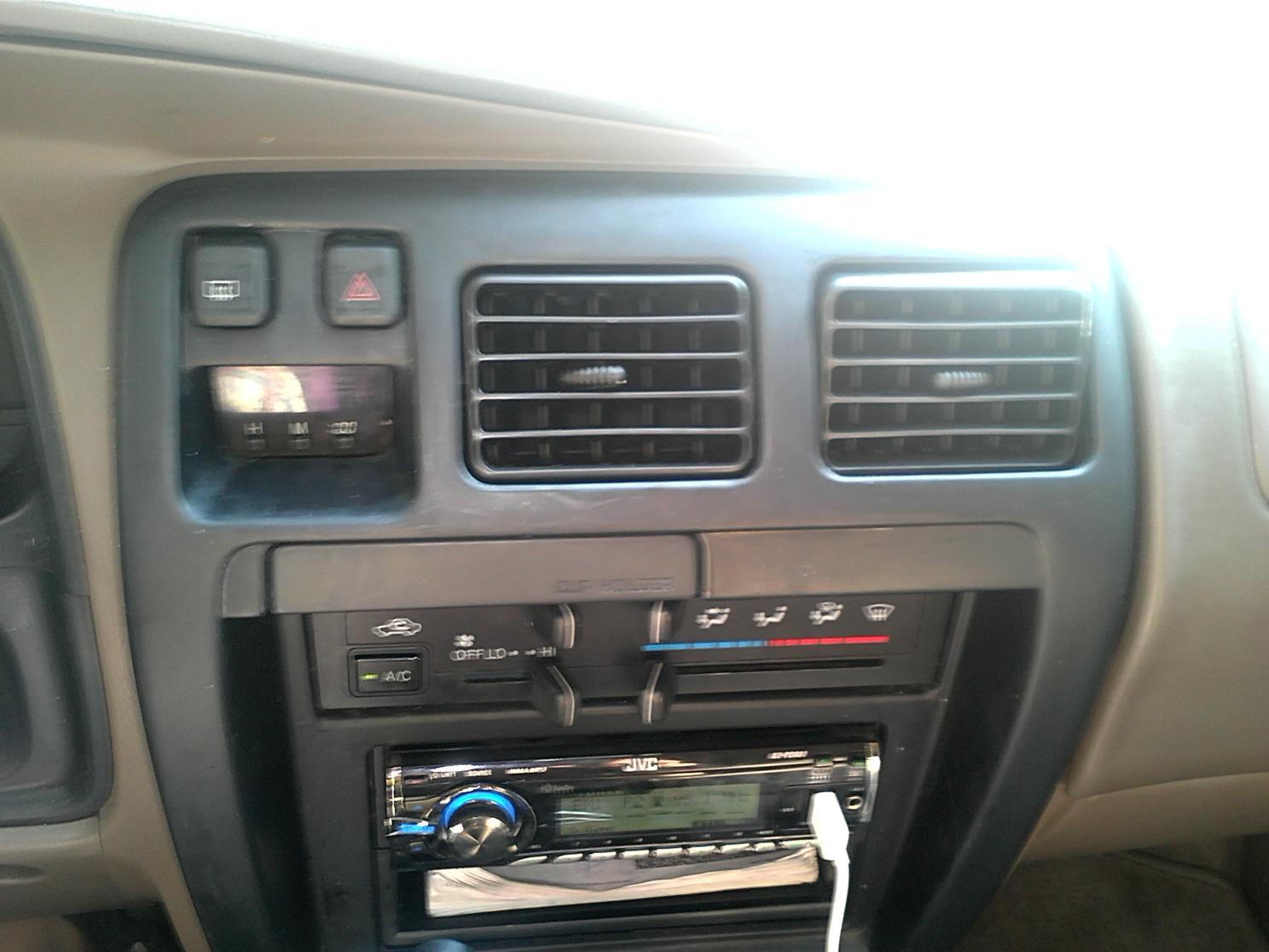

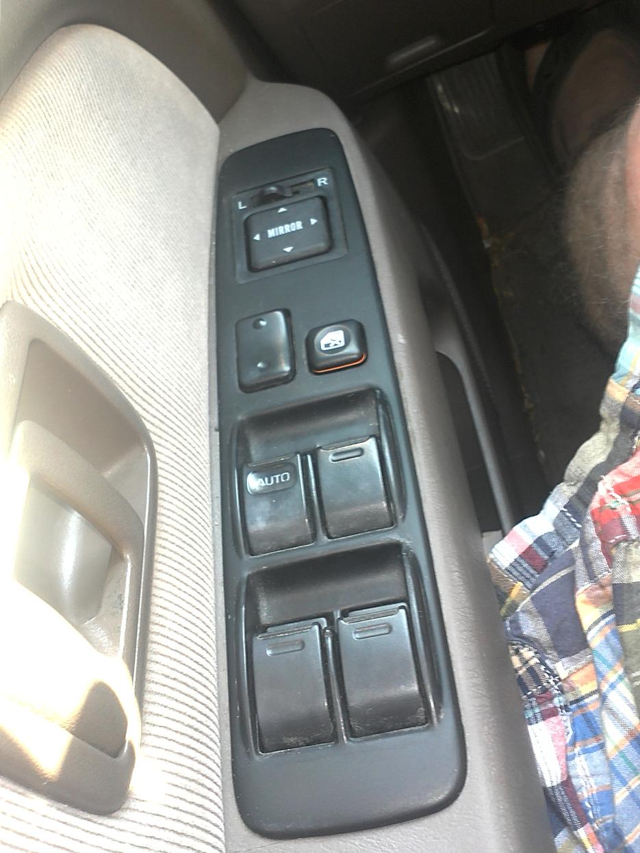

I took a pretty heavy duty knife and would start with a corner. Once I got it started, I would pull with one hand on the wood grain and use the knife to cut/pry the tape holding it in. There was a lot of tape left over that I had to use my hands on to remove it. Scratch and peel with your fingernail. When I was done I used mineral spirits to clean it up. Be careful with the mineral spirits. It will start to take off some of the paint on the plastic if you are not careful. Here is what it looked like before peeling with my fingers. My hands were worn out afterwards.
