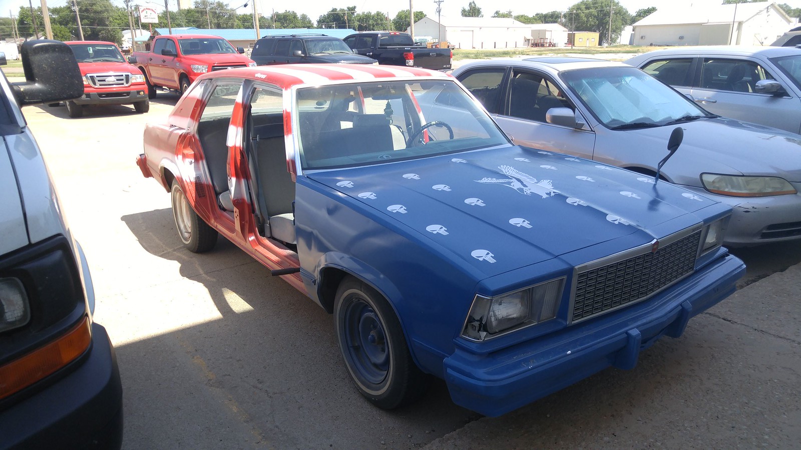

Funny you revived this thread, my buddy at work just did this with one of his cars...
