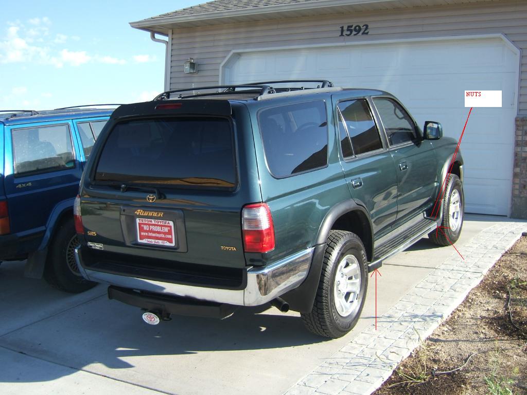

I'm not sure we're talking about the same thing. I stole a pic to show you. The 2 plastic pieces go over the running boards in the front and back. Where it says nuts, they are located underneath the running boards and just spin in place. The nut underneat is the only part I can get to.

It looks like you might have to remove the entire running board to remove those plastic pieces. I'm not sure how else you'd do it.
Yeah I might have to remove the whole running board. That may help to get to it better, but the plastic top of the running boards still resides under the 2 plastic pieces in question.
no those 2 smaller pieces come off first. I know those bolts your talking about and yes they should just screw off in theory. However when i got to my other side, they had been broken off and that front piece was only held on by the bolts in the wheel well.
