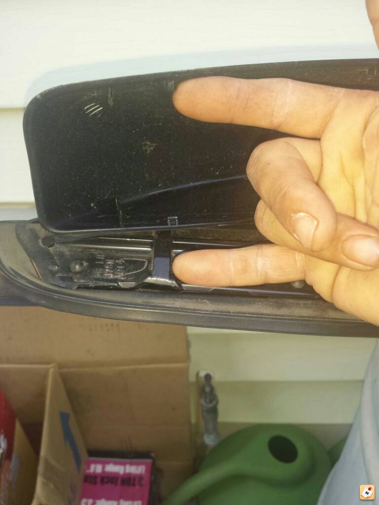

In the first pic ypu can see where it snaps in.

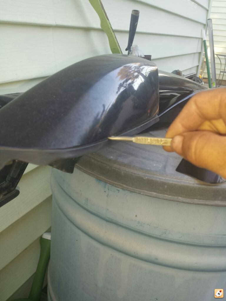

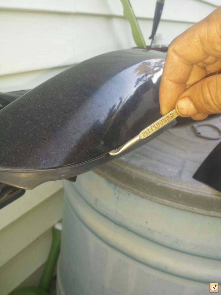

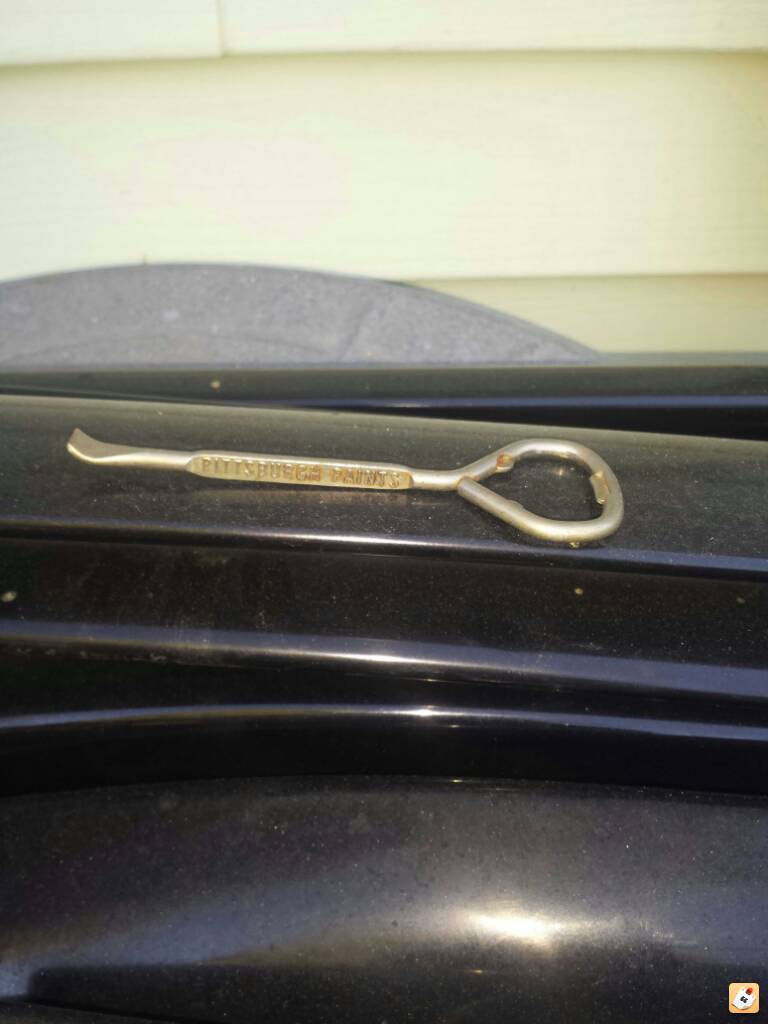

Get the opener between the cap and seel and gently pull out with the opener while lifting up on the cover with your hand. The opener is used for opening your standard gallon paint can. If your neighbors dont have your local hardware store will for a buck or 2. If you destroy your cover I do have all 4 from my rack. Trying to sell the whole rack but I dont see many tr4 without one
