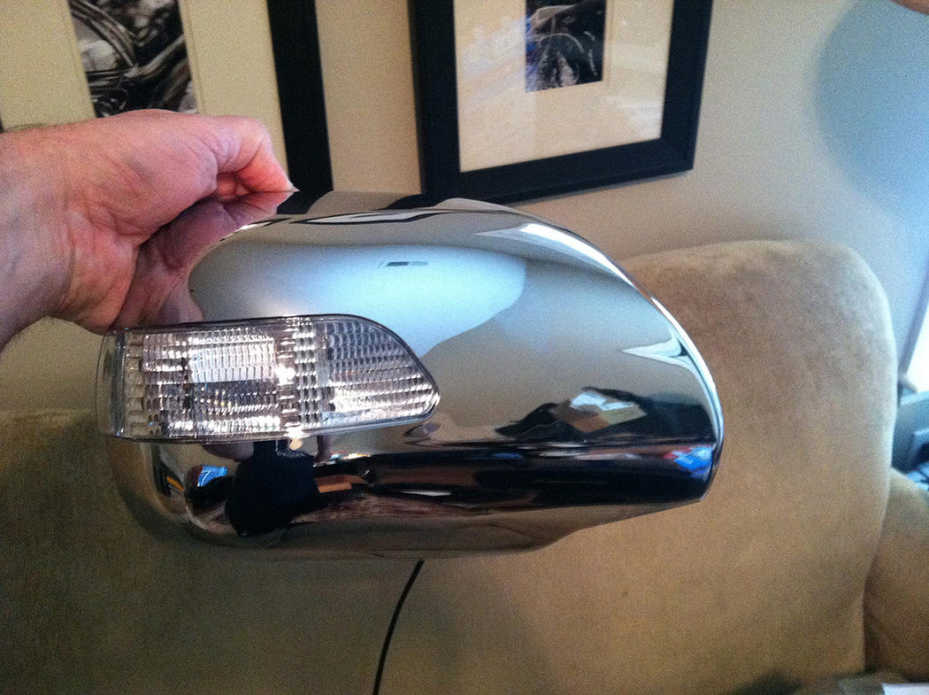

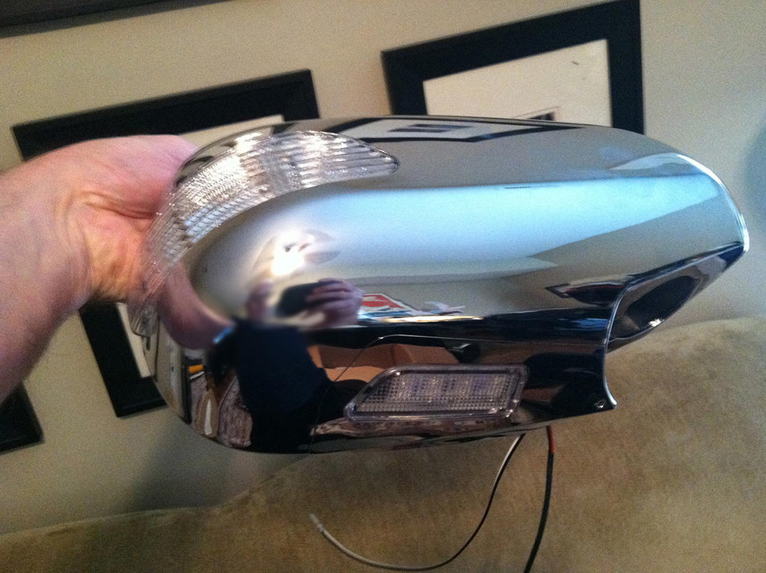

Well, in a strange twist of fate i ended up getting these in the mail today. They have the LED turn signals and puddle lights. I will just need to have them painted before i put them on.
You're going to love them Morris! Good luck with the install!
It will be fine. When i switched to the 06-09 grill i painted a chrome grill.
Interesting, last time I tried to paint chromed plastic, it didn't real do well until I stripped it and at least scuffed up the coating enough to give the paint something to adhere to.
Yeah, the chrome has to be scuffed and then using an adhesion promoter helps.
