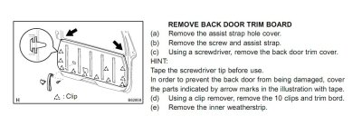

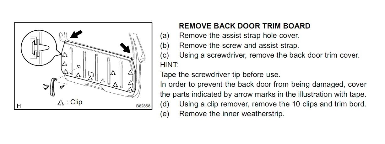

I just pulled mine off when I replaced the License Plate Garnish Assembly. It actually comes off really easily. After removing the strap, just use a plastic putty knife (or in my case I used a gasket scraper and put tape over it - worked great) to pop off the panel. once all the clips are popped lift it up about a 1/4 inch to clear the lip than hangs over the edge next to the glass and it comes right off.
