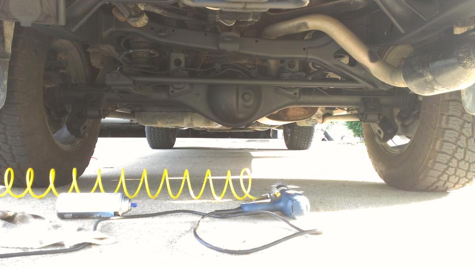

So i got bored today and randomly decided to do this. It turned out pretty good but, i only got done with this much for today. P.S. it had 5 years worth of Minnesota/Illinois's winter rust

looks good. I get the air line to spray off dirt/dust and the paint, but whats up with the heat gun?
oh ok lol, that makes a lot more sense. I need to do this to mine. what did you use to coat it with?

the only thing i was worries about was the diff getting hot but it doesn't seem to as i can still touch it after a long drive
