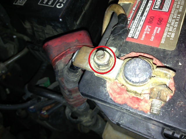

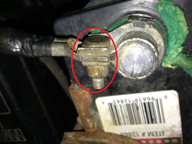

Thanks for your help guys. Am I correct in understanding that by removing these bolts, the terminals will separate from the existing wiring?

nope..... the negative wire (that goes down below the oil filter) is crimped onto that terminal. you will need to either cut the wire and re crimp/ solder on a new tip for the new terminal.
the positive one will unbolt like you want.
on my old one i just cut the clamp off at that bolt and just used that bolt hole to mount to the new terminal, et some vise grips and grab the terminal at the bolt hole and cut the terminal, flatten it out a bit and secure to the new terminal..kind of hard to explain but if you cut it right you can just hook it all up without crimping
cut on blue line, haha
neg_zps97b13f26.jpg~original
I like the idea of not cutting the existing wire and crimping. Thanks for sharing. Can I just use a simple hack saw to cut along the blue line? That's a tool I already have.
yeah but go easy on it, it's thin and has a tendency to twist if not firmly clamped, should work but it's going to be a pain trying to saw and hold the cable, no dremel or any sort of grinding or cutting tool? a saw will work, as it has for thousands of years, but it's not going to be fun.....an really it's a bit foggy you may have to do a bit of clean up work to make it fit nicely, i would really suggest a dremel type thing.
i just had a look at mine at it "should" work but make sure you look at the clamp before sawing and get the right spot!
i know this method works but not sure if you can make it happen with a hand saw...
alternatively, i have a crimper for those wires if you just want to buy nice ones and pop by tomorrow and sort it out?
