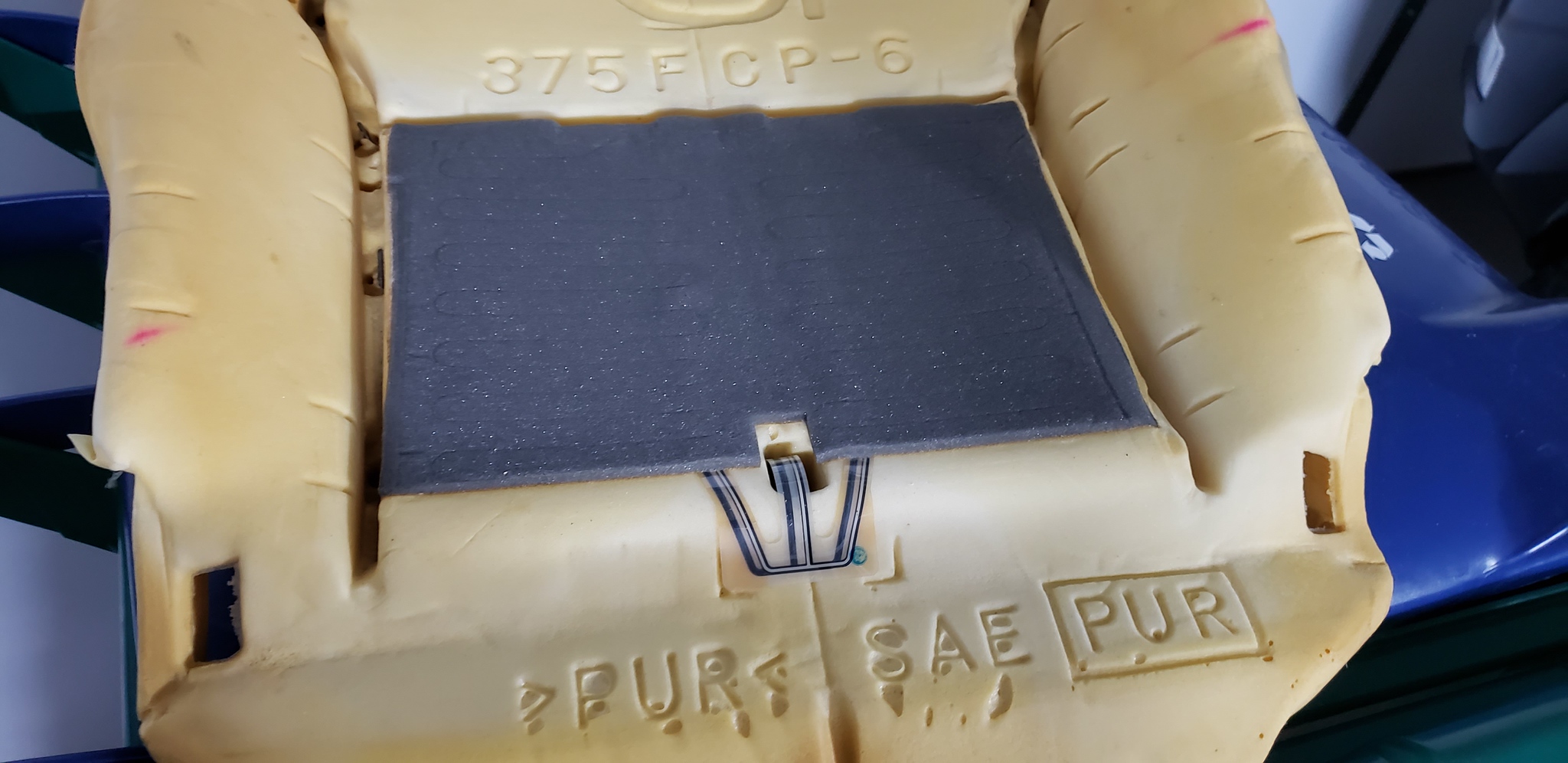

That part number is for the driver side only.
The passenger side will be different since it has the air bag weight/pressure sensor in it and is not transferable to the new foam. It's actually molded into the seat foam.
This is the passenger side foam with the sensor coming out the back, the three flat cables.
The seat heaters are attached to the factory seat covers, or at least the factory leather ones. Those can be transferred over if replacing the seat covers.

Interesting, I didn't know the weight switch was in the actual seat foam itself, but I learn something new everyday! All of your pictures are great, definitely a great resource for anyone looking to swap the seat cushions and covers.
