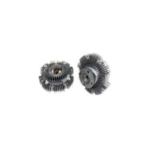

Newbie here, been reading a lot over last few year and finally purchased some 4runners. The one in question is my 1 week old 96' 4Wd limited with 183k on the 3.4 v6, it's automatic. Everything appears fine but overheats when driven up hill in the mountains pushing 3K RPM. After some reading I've come to the conclusion that I have a bad fan clutch, spins fairly freely at cold or operating temperature. I am mechanically inclined and just wonder if I could save a few bucks rebuilding my fan clutch as opposed to shelling out the $100+. Any advice is apreciated in advance.

Lol, I couldn't resist. Most people just choose to replace them. Try googling it. You may dig up some how-to's from here and Tacoma forums on rebuilding them. If you do get a new one, stick with Aisin brand fan clutches.

This guy is trying to upgrade by changing to a heavier oil, but if lost fluid is your issue it should cover that, too. The other possibility is a seized or broken bimetal actuator valve. I figure if it's broke, it's toast. If it's seized, free it up. That should cover it, it's a pretty simple piece of hardware.
I got a new Aisin OEM clutch for like $65 at the time from partsgeek.com. Rebuilding didn't seem worth it, it had been on duty for ten years. Here's a link to a good thread on changing fan clutches...link is to my post...sorry about that:1998 3.4 Auto 4Runner, Overheating Issue, Suggestions? - Page 3 - YotaTech Forums

Do you have a part number? And did you use the blue clutch?
Check your radiator. I too had the same problem during the summer when I cross the Sierra Nevada mountains. Fan clutch spins freely and I replaced it. Bad guess. It was a clogged radiator. How old is your radiator?
