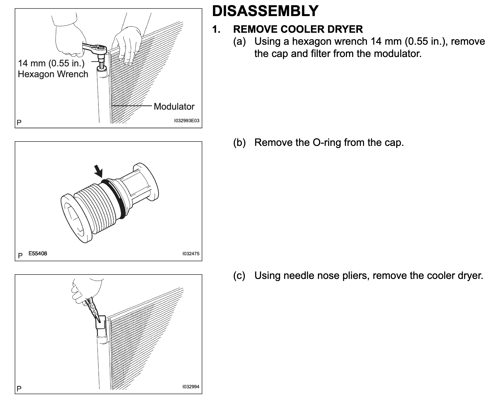

Reviving an ancient thread. Has anybody done this and can give cliffs notes?
And where can I locate the dessicant? Doesn't seem worth replacing the whole thing if the dessicant can be done separately along with some fresh o-rings.

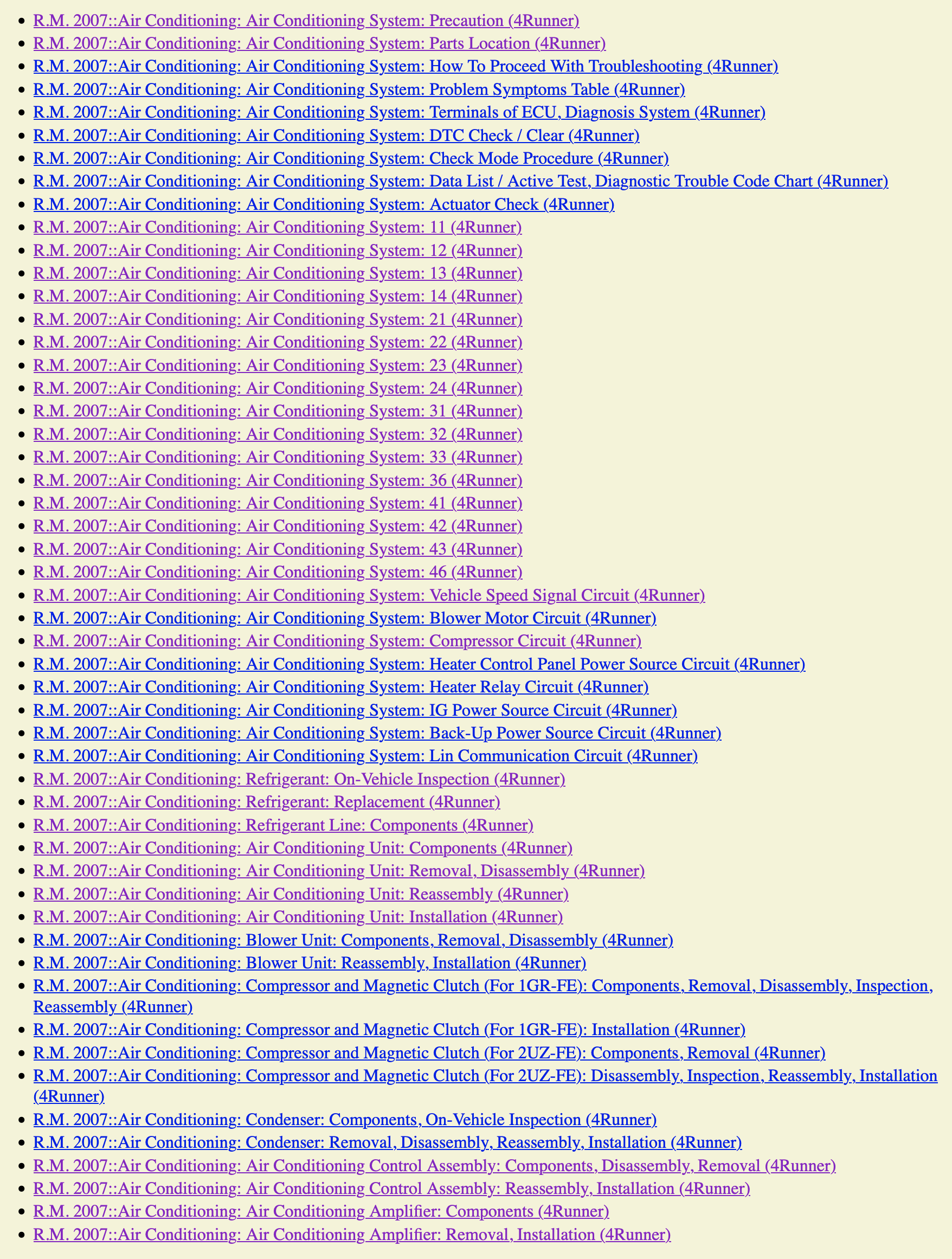

Download entire repair manual and find PDF to replace that part.
https://www.toyota-4runner.org/3895755-post7.html
Yeah that manual's a mess. Reason I asked if anyone had done the job.
You see a drier in here? Yeah me neither.
I guess you'll have to keep looking. Lol
Took less than 1 min to find the correct PDF in repair manual.
Could not be any easier to find.
I commented so you might actually find the info yourself, before I got home from work. Lol

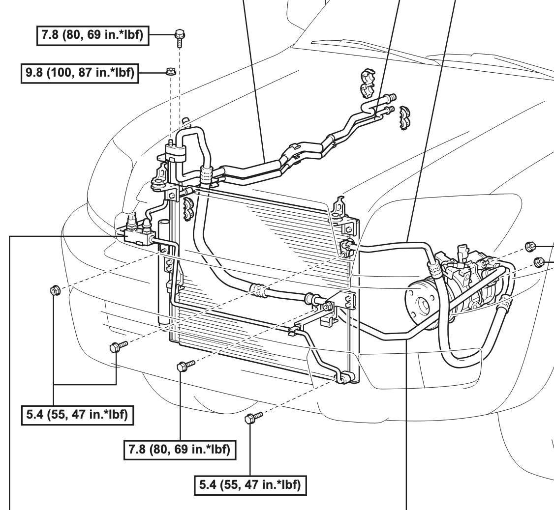

Air Conditioning: Condenser: Removal, Disassembly, Reassembly, Installation
ileaf/07toyrm/07toypdf/07rmsour/4runnerr/0430038.pdf
From the PDF
REMOVAL
1. DISCHARGE REFRIGERANT FROM REFRIGERATION SYSTEM (See page AC-103)
2. DISCONNECT DISCHARGE HOSE SUB-ASSEMBLY
(a) Remove the bolt and disconnect the cooler refrigerant discharge hose sub-assembly from the cooler condenser assembly.
(b) Remove the O-ring from the cooler refrigerant discharge hose sub-assembly.
NOTICE:
Seat the opening of the disconnected parts using vinyl tape to prevent moisture and foreign matter from entering.
3. DISCONNECT AIR CONDITIONING TUBE ASSEMBLY
(a) Remove the bolt and disconnect the air conditioning tube assembly from the cooler condenser assembly.
(b) Remove the O-ring from the air conditioning tube assembly.
4. REMOVE COOLER CONDENSER CUSHION NO. 2
(a) Remove the nut and cooler condenser bracket No. 1.
(b) Remove the 4 bolts, nut and cooler condenser 33500
AIR CONDITIONING – CONDENSER AC–141
5. REMOVE COOLER CONDENSER CUSHION NO. 1
(a) Remove the 4 bolts and cooler condenser cushion No. 1.
6. REMOVE COOLER CONDENSER CORE
(a) Remove the cooler condenser core.
DISASSEMBLY
1. REMOVE COOLER DRYER
(a) Using a hexagon wrench 14 mm (0.55 in.), remove the cap and filter from the modulator.
(b) Remove the O-ring from the cap.
(c) Using needle nose pliers, remove the cooler dryer.
