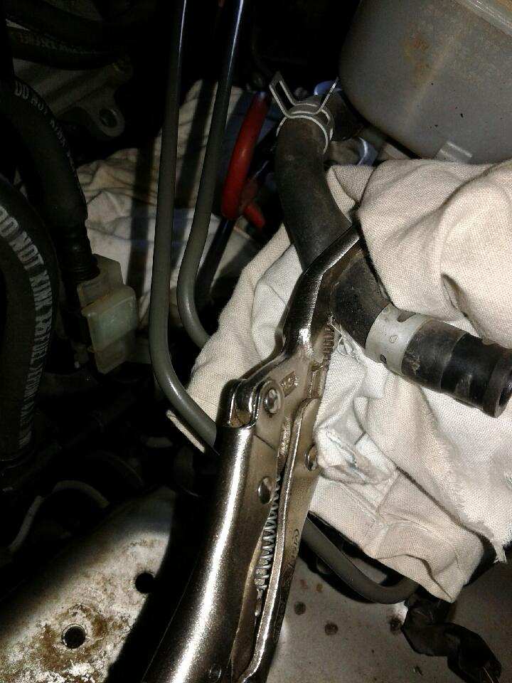

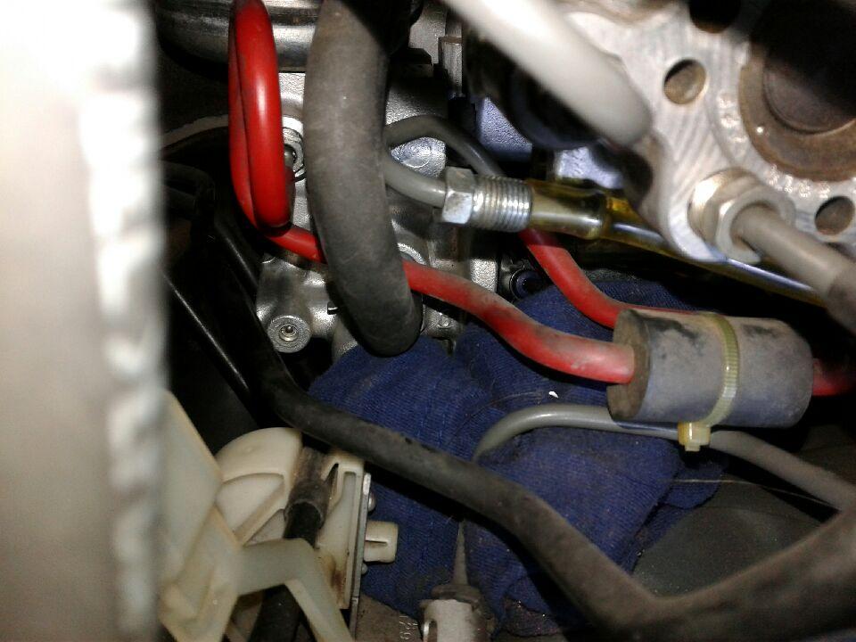

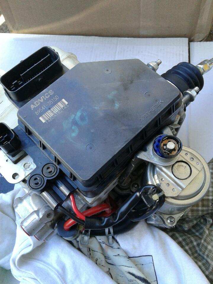

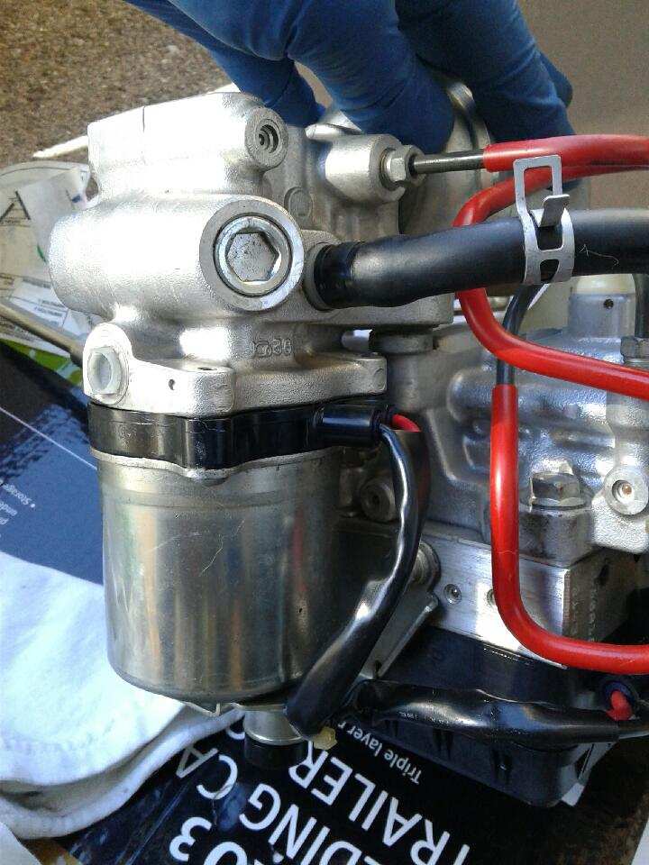

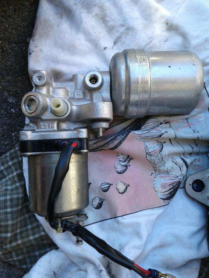

This is what things looked like when I received the used part and started disassembling things.

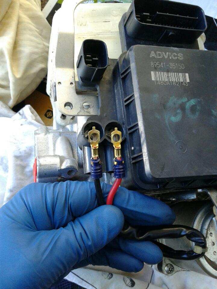

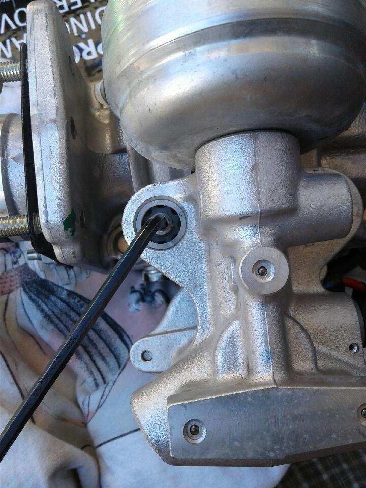

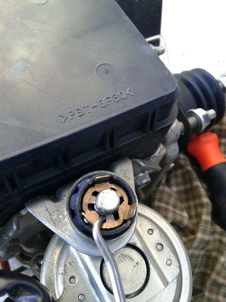

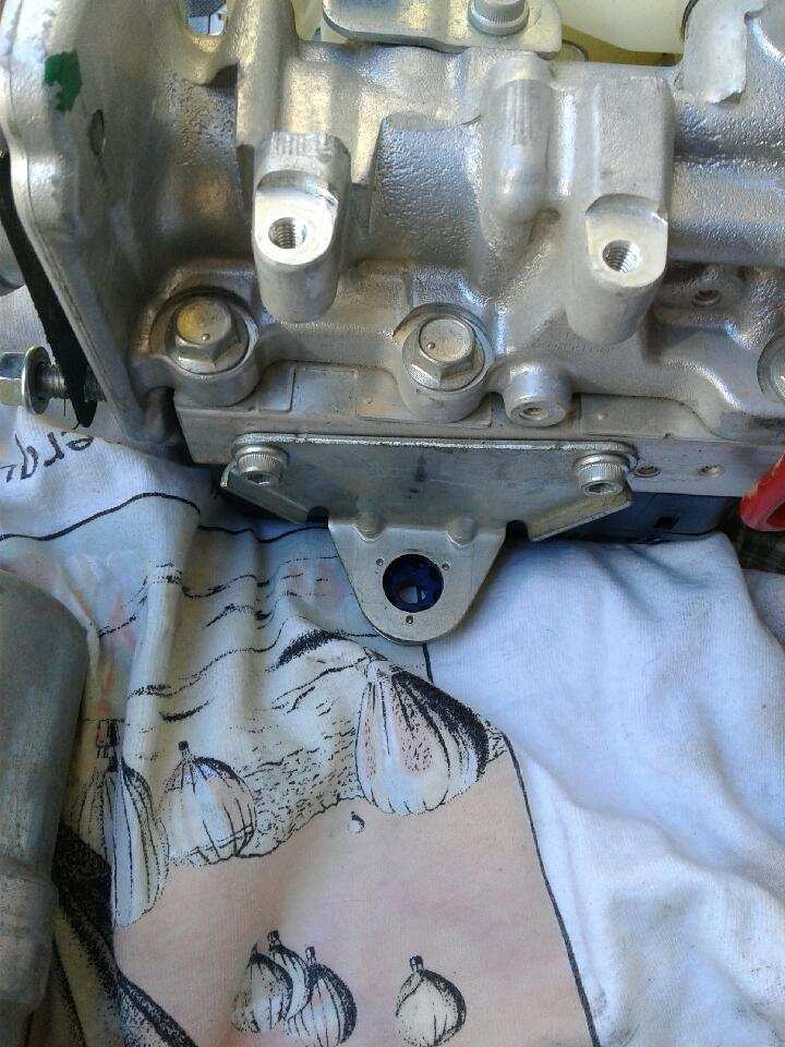

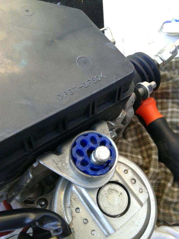

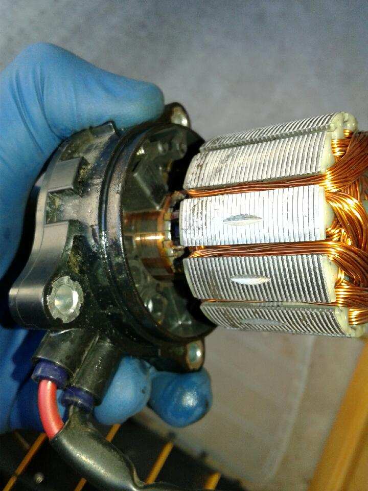

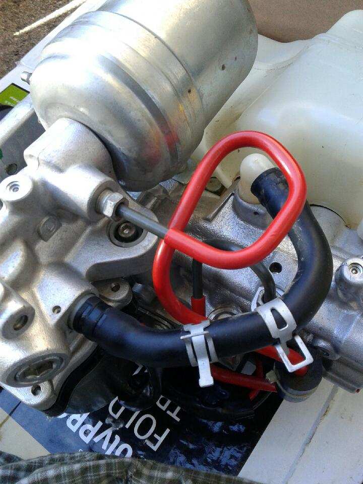

Pictures of removing and disassembling the motor, pump and accumulator from the main assembly. That little copper colored ring is a bear to remove and almost as much fun to straighten out. You could probably just removed the bracket that the rubber mount is in but you'd have to use a short hex key and be doing all the work blind since it sits on the bottom of the unit, and you have very little space to work with between the bottom of the unit and the top of the wheel well. I will say that the motor from the donor unit was in a lot better shape than the one I pulled from my '05. The brushes looked almost new and there was very little dust inside the motor housing. In my '05, the brushes were about 1/2 gone and there was a LOT of black dust inside the housing.

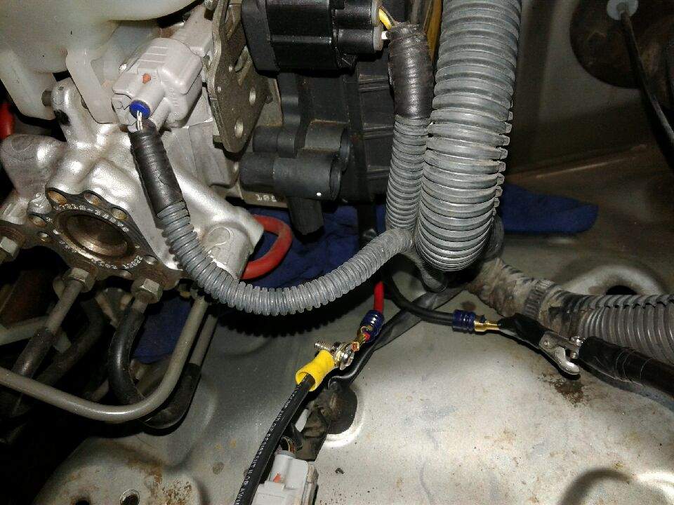

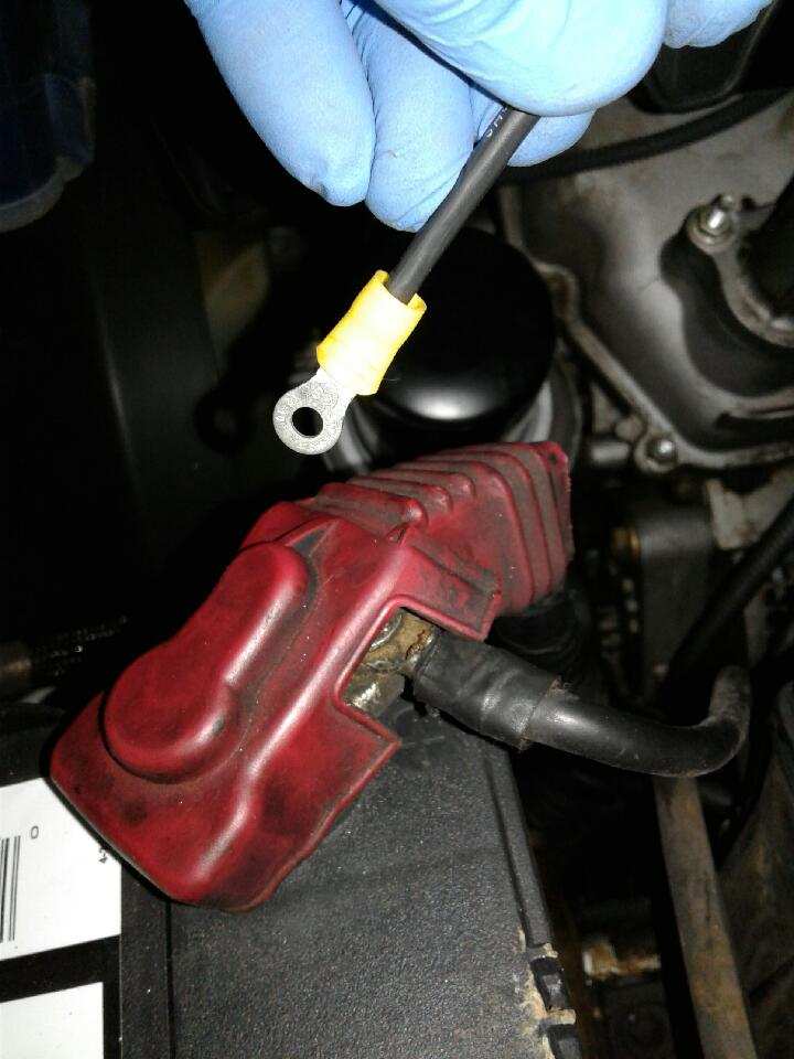

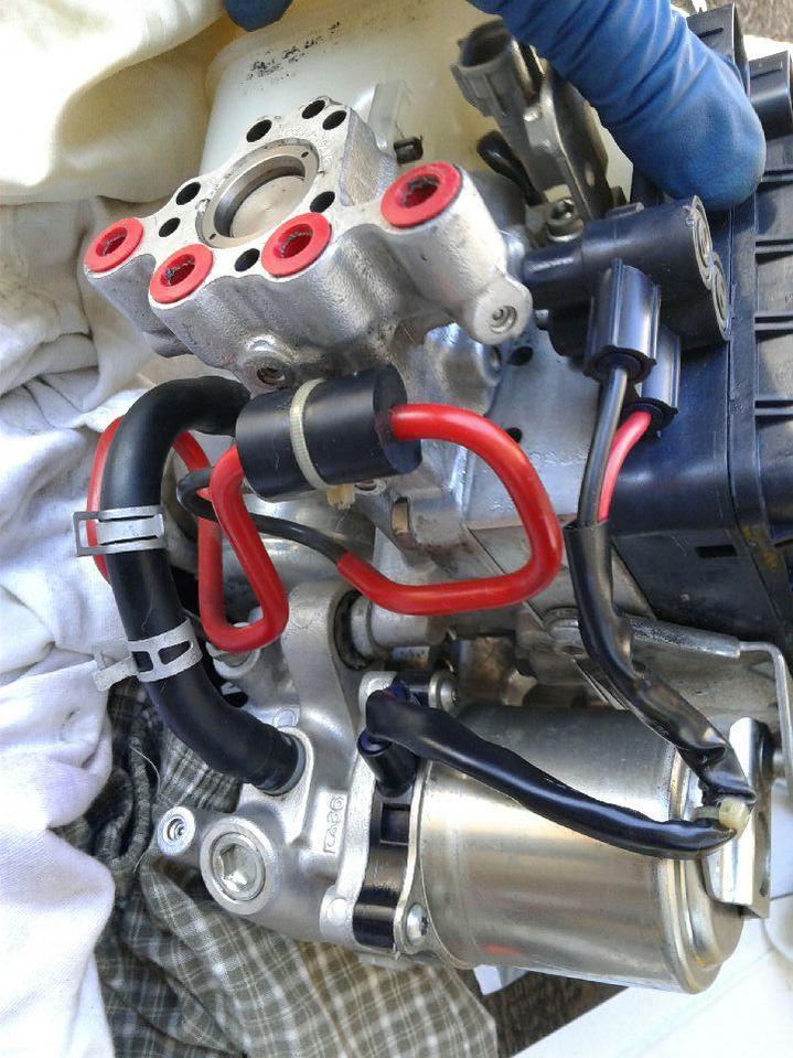

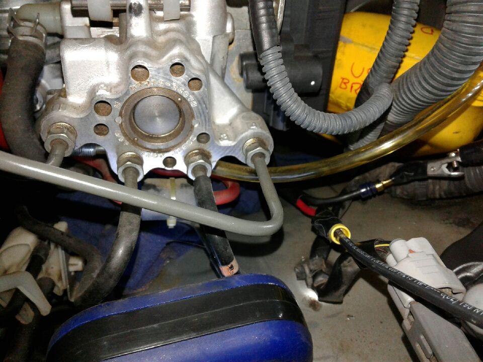

The red and black wires in the previous post are the leads that power the motor. The photos you see below show how I ran extensions from those leads and powered the motor straight from the battery to purge the pump and accumulator without having to turn the key on to the vehicle. These photos also show how I rigged up a clear vinyl tube to the high pressure line (when it was removed from the MC) and pumped the purge-fluid into an old oil bottle. Oh, and the picture showing the black rubber hose shows how I used some vice grips to clamp the line so that the brake fluid in the reservoir wouldn't spill out everywhere while I was swapping out the pump/accumulator assembly.

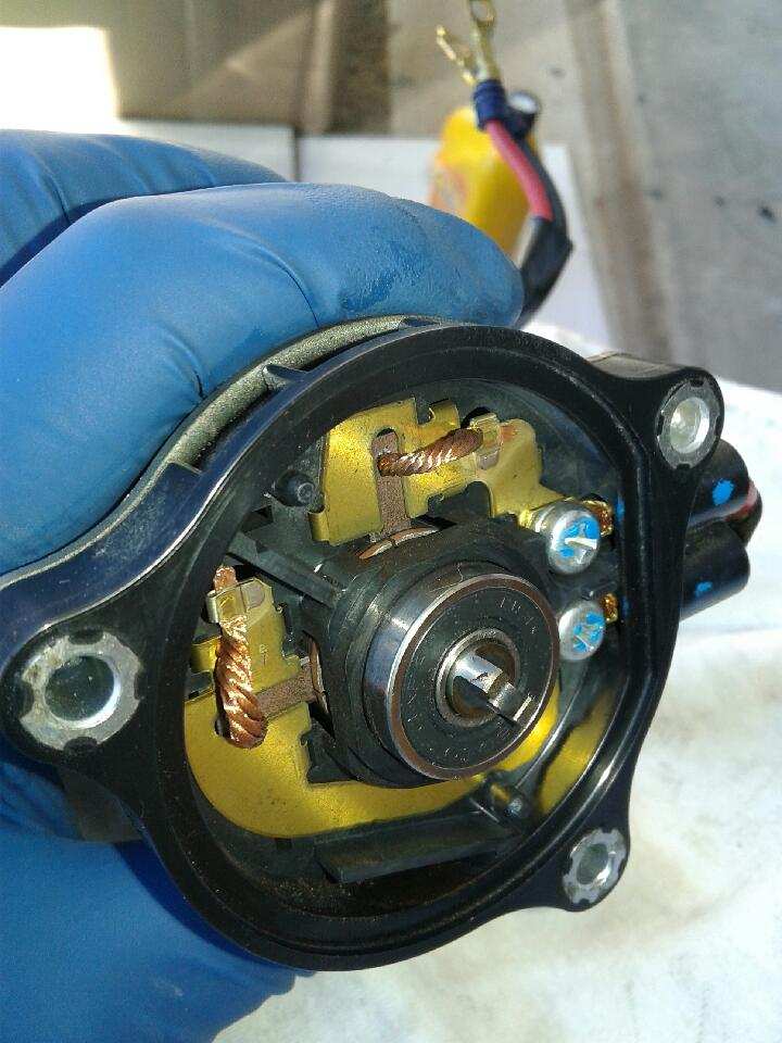

This is just a wild guess and not based on my personal experience, but I think you should remove the boost motor and inspect its condition. My suspicion is that there are either some mechanical issues with the brushes, a bearing has gone out or some object has gotten wedged between the rotor and the outer case/magnets.
The motor is pretty simple to remove if you already have the old unit off the vehicle. You need to disconnect the red and black leads from the side of the ECU, which requires prying out the rubber plugs and unscrewing them. Then there are 3 screws that hold the motor housing onto the pump.
Once the motor is removed, there is a black rubber dust cover that simply peels off to expose one side of the stator/brushes and one of the bearings. A little bit of prying between the black plastic flange (rotor housing) and the metal flange of the motor housing will eventually allow you to separate them and then you'll be able to see what's inside the housing and around the rotor. The magnets will try to keep the unit together so be prepared for a little resistance when prying apart the housing.
