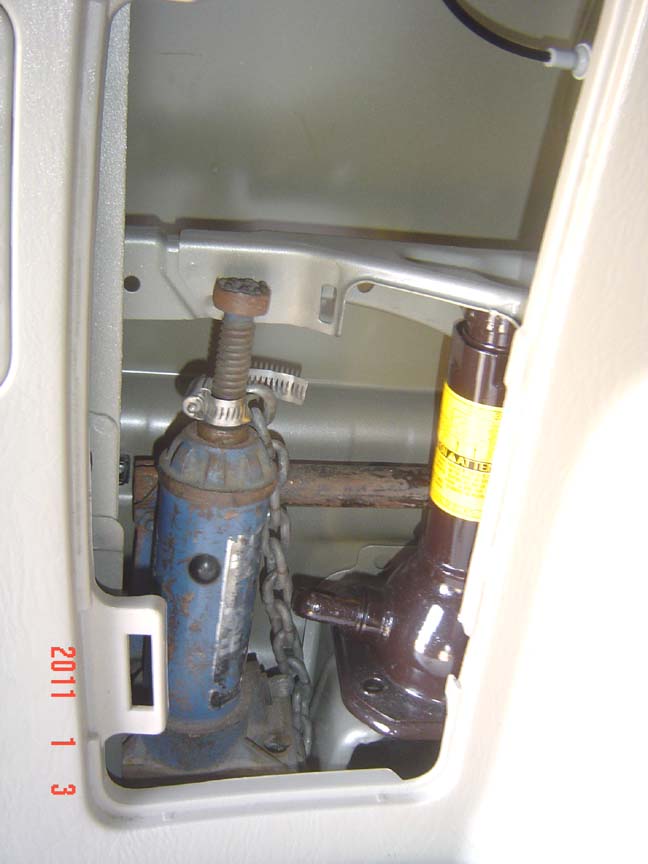

I have a stock jack and bottle jack in my 07’s compartment due to my variety of uses and towing trailers. The stock jack appears to be in place with a little upward pressure to eliminate movement noise. The bottle is not noisy or I would have foam around it.

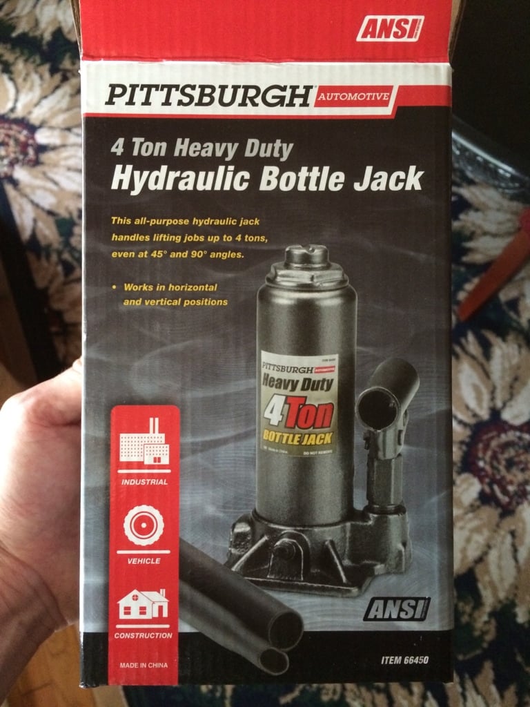

Found this bottle jack from HarborFreight. It will do for roadside tire changes. $17.99 before tax. Thanks, all.

If it were me the issue would be the maximum lift height of the jack. The one pictured has a max height of 15 1/8".
I believe the stock jack has a higher lift height due to the fact that it is a two-stage jack, kinda like this one: Two-stage bottle jack w/19" lift height. Not sure, however, that this one would fit in the storage compartment.

4runnerfan is correct. I just bought the 4ton bottle jack from Harbor Freight and it does NOT lift high enough. Just an FYI for anyone considering buying the harbor freight for replacement.

i have that jack you linked to. i have a few problems with mine. i dont know if we tried to jack to much or what but after using it under the house when installing a new 4x12 the jacks screw portion is stuck half way up and every time i use the jack it leaks fluid
You messed the seal up in it, as to much pushing tonnage for the jacks use.
Had to do the same under my house, used a 20 ton jack though. No problems, listen to the whole house creak doing it.
we put a 4x4 under the thing to be able to jack more and ended up just jacking the board into the ground. it did the job is was bought for so if it has some problems now its fine. i still use the thing for lifting the truck if need be
