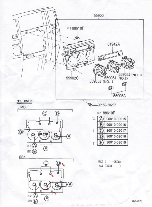

Hopefully the attached diagram with part numbers for each specific LED will help someone else. :)

This worked awesome. Thanks so much. Only mess up was the Toyota dealership gave me the wrong bulb for the Multi Function Display :)
