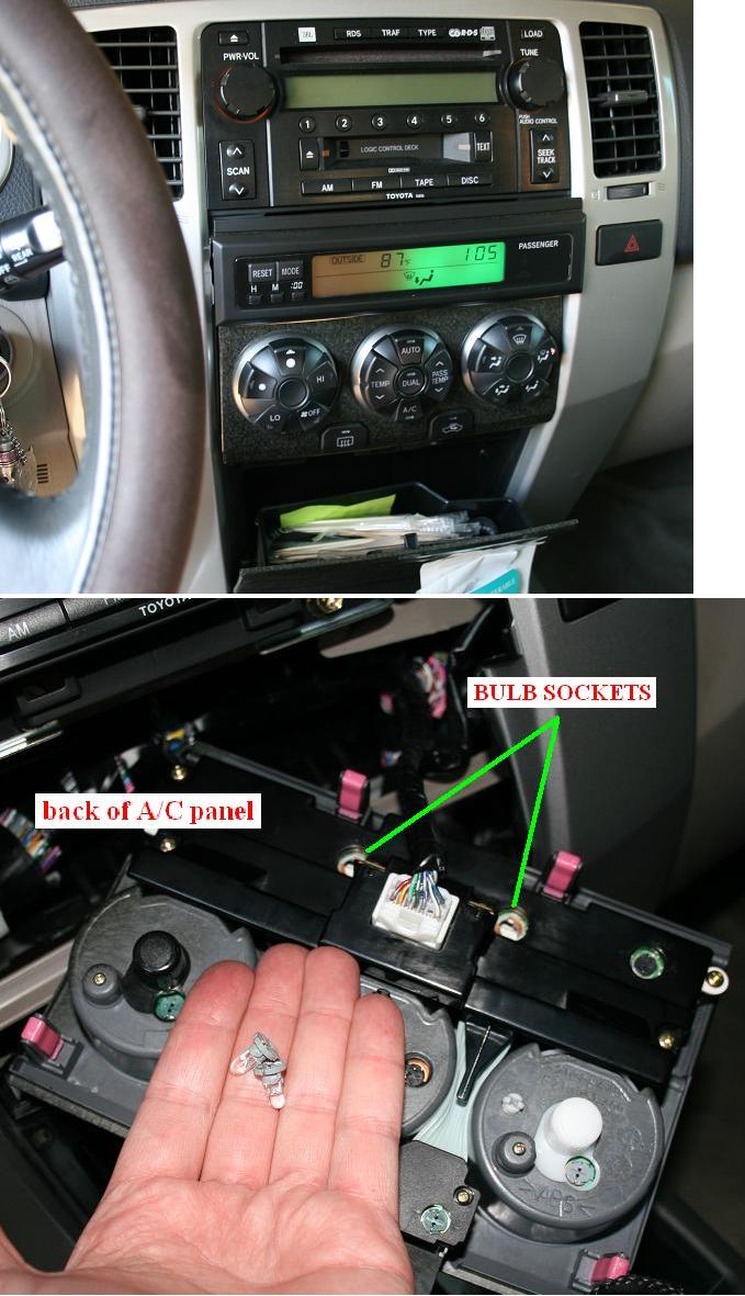

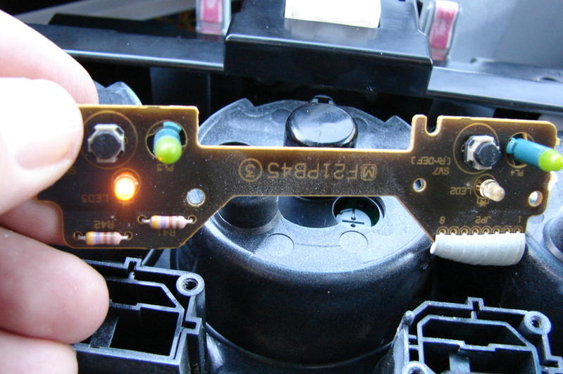

Does anyone know how to remove the bulbs "C" on the instrument panel. I successfully removed the panel and located the bulbs. I have managed to remove other bulbs on the panel, but the "C" bulbs that serve as the backlight for the time clock appear to be soddered to the circuit board.
Could anyone give me help on how to remove the "C" bulbs in the diagram?
for the C bulbs just use a screw driver or do you have the panel upside down & looking at the wrong ones?

I was able to change the C bulbs. Thanks you very much Chaz. I just wanted to make sure I did not permanently damage the A/C panel, since replacing the entire unit would be very expensive.

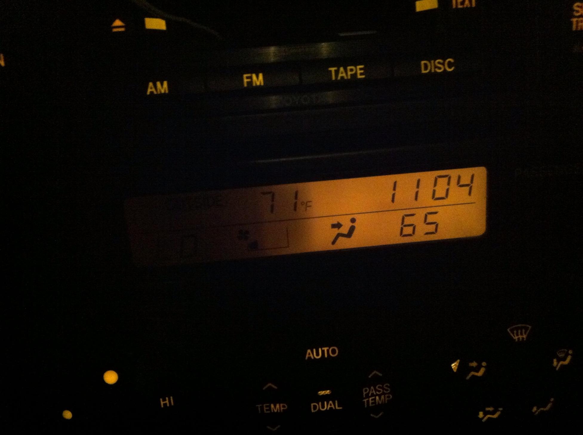

I replaced light bulb C thinking it would fix the darkness on half of a/c lights. It did not. As you can see from attached pic. Any help would be great!! Thanks

I have this same problem in my '07. I've replaced the bulb twice - once the dealer sold me a bulb with a gray base and once it was a blue base. I want to say one didn't work at all and one kept it very dim like yours. I replaced the bulb with one from my '05 and it worked like normal.
I gave up for the time being and it's just dim on that side now. I even switched sides for the bulbs and the other side was dim. I'm not sure why some bulbs go to "half brightness like that", or why a new bulb from the dealer would already be dim. Maybe wrong wattage or something, but I'd like to know the answer as well.
x2 Gillygirl
thats exactly how mine is!...strange that u replaced bulbs and still no dice?...i opened up mine to install an amp n then when i put everything back...my screen was like urs...guess i broke a bulb in the process...will look at the part nos and buy 1 pair of bulbs
