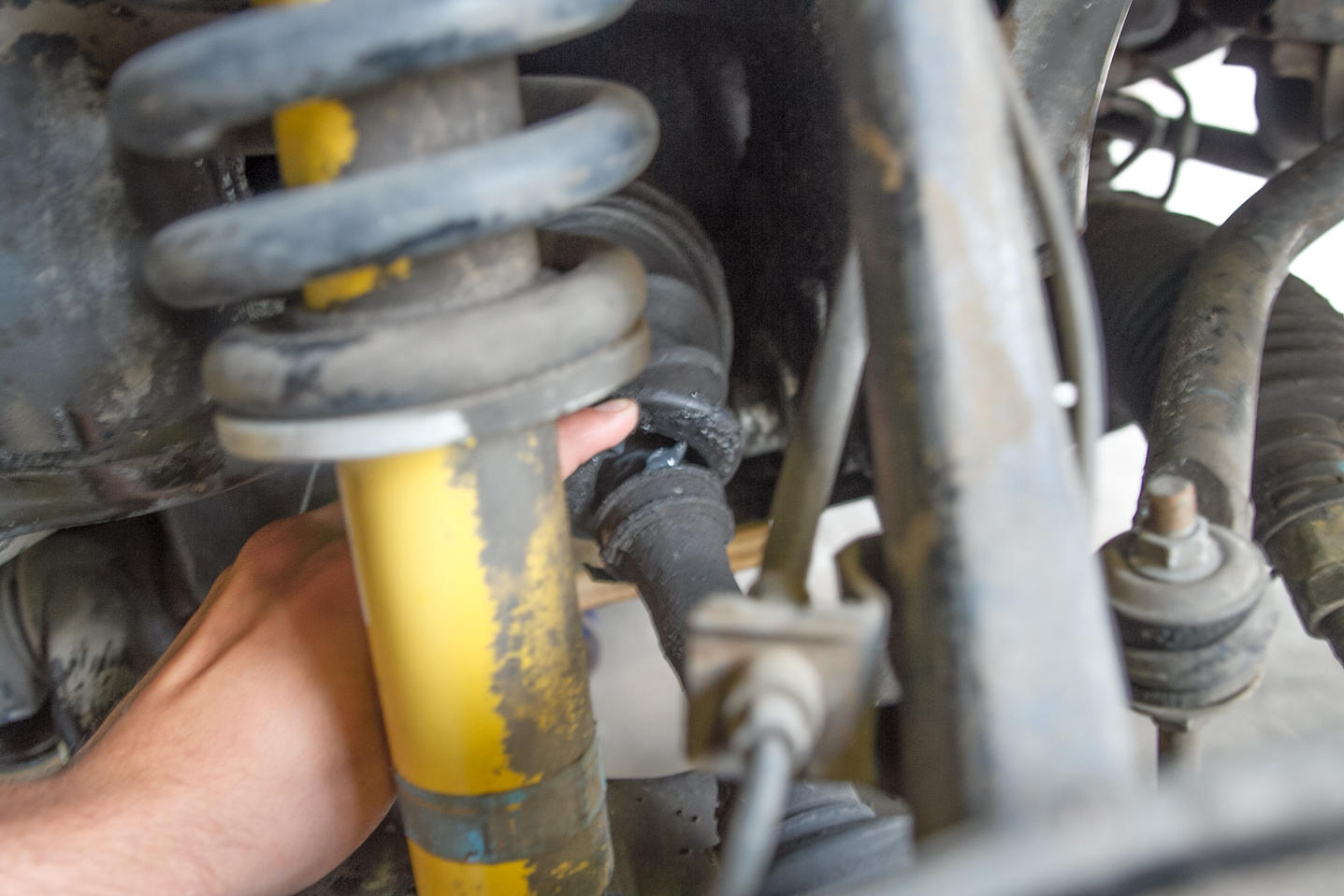

Here is the torn boot:

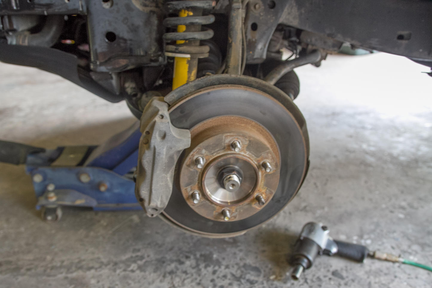

First take the wheel off. Then used a mallet and chisel to take the hub dust cap of extremely carefully and evenly so we don't dent it. then unscrew the 35mm spindle nut (in the center of the hub)

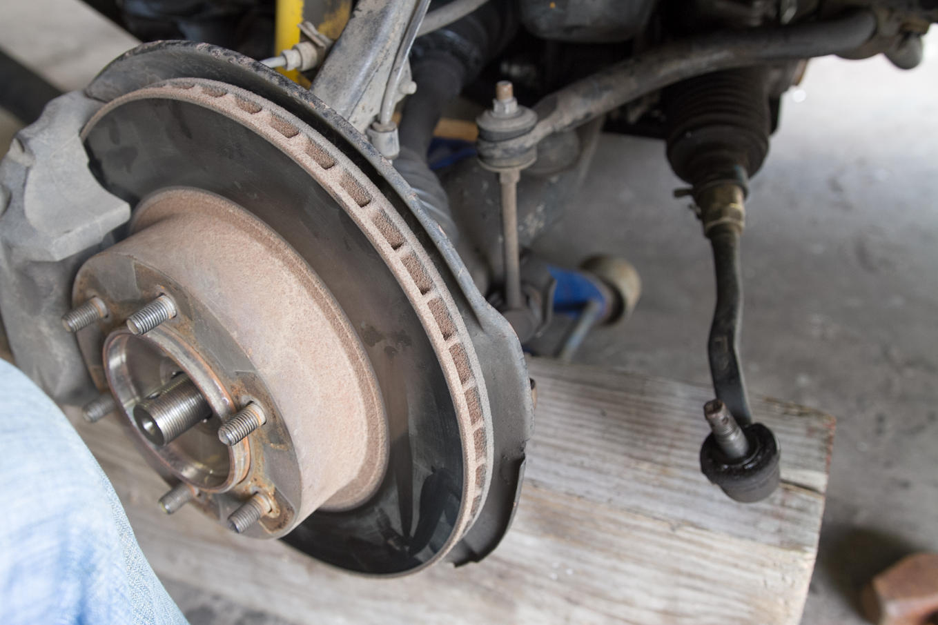

Then disconnected the tie rod

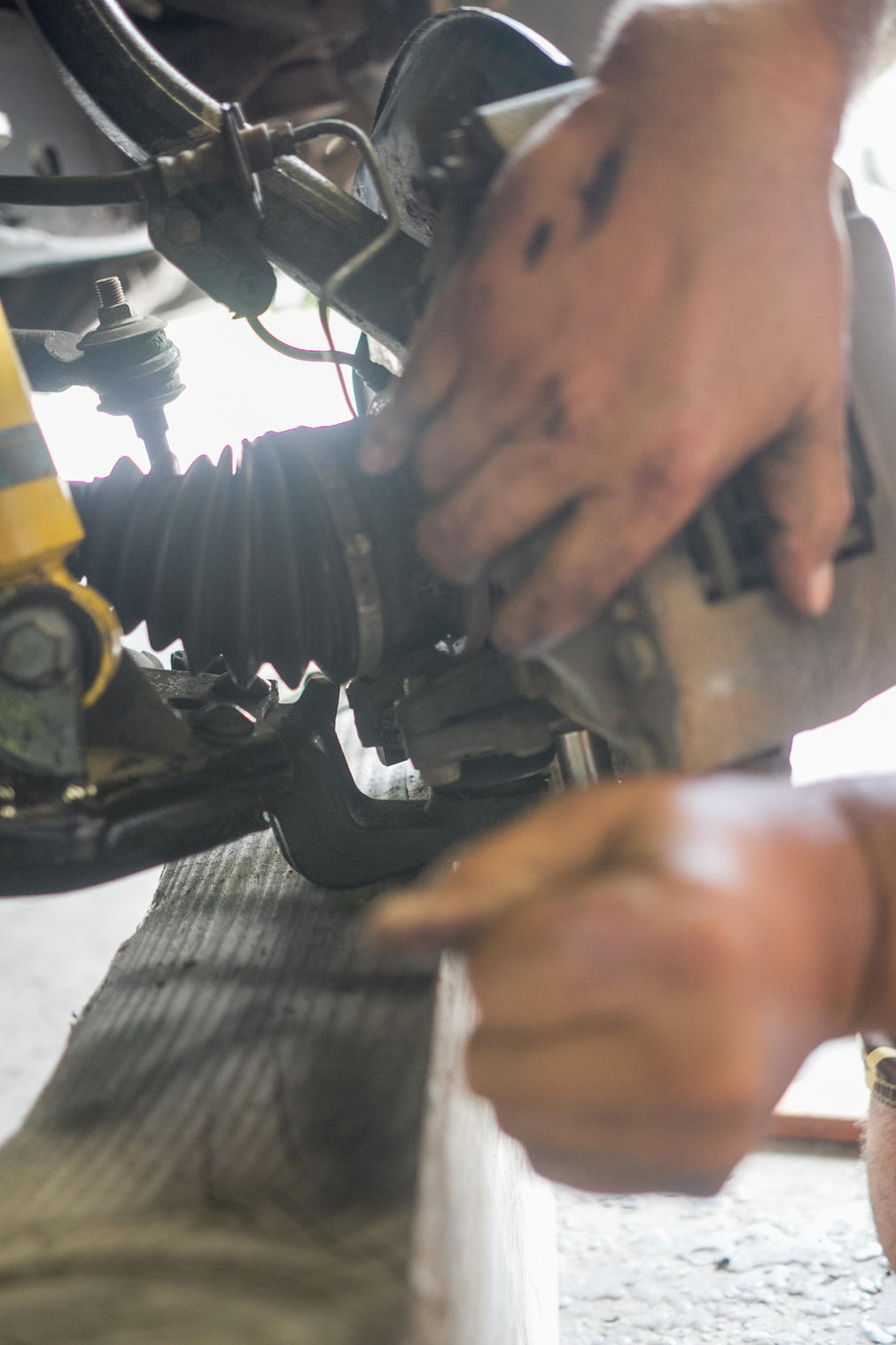

Then with the brake router area loose use a mallet to gently pound the cv axle out the back.

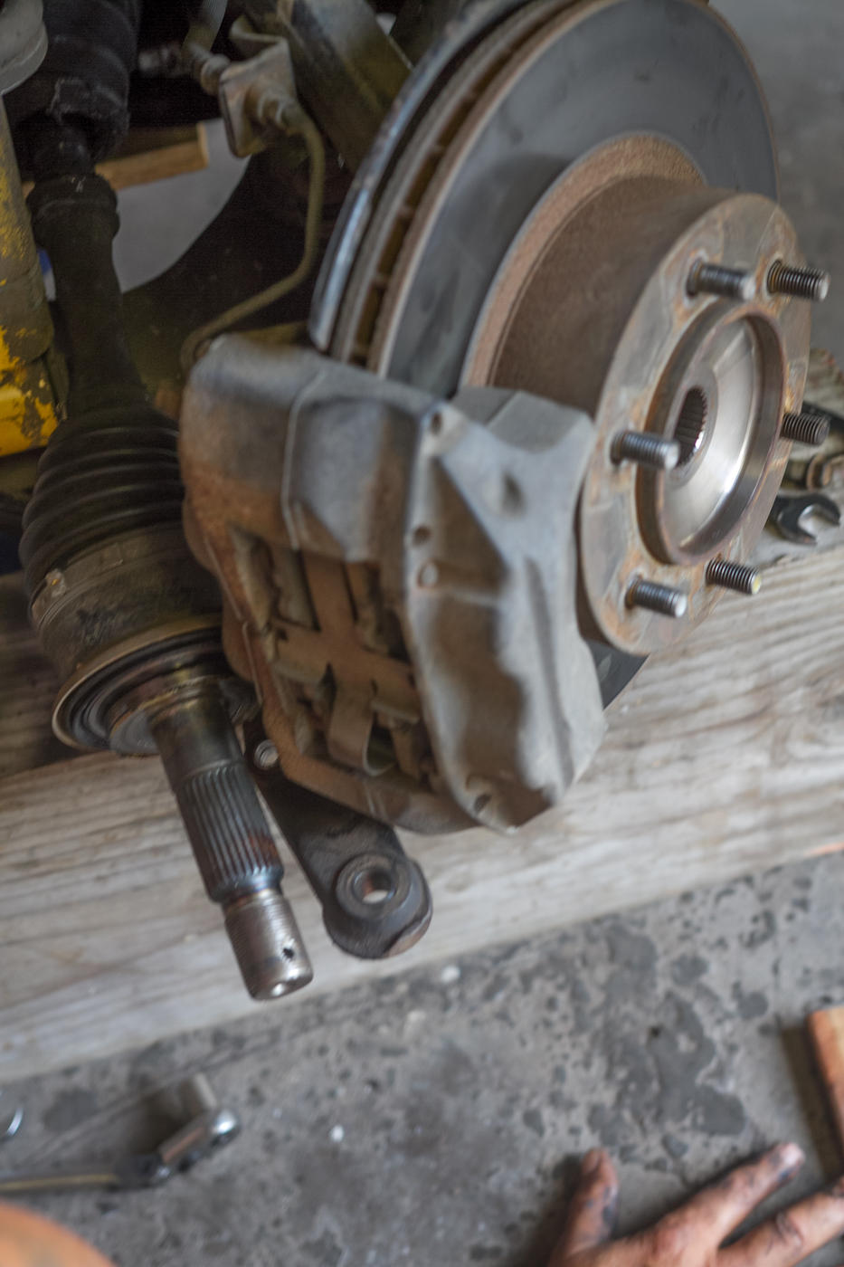

Prying the inside of the axle out was a pain, used a pry bar or flat head to pry the rest of the axle out. Didnt have pics of this part because my hands were super greasy, but here is what it

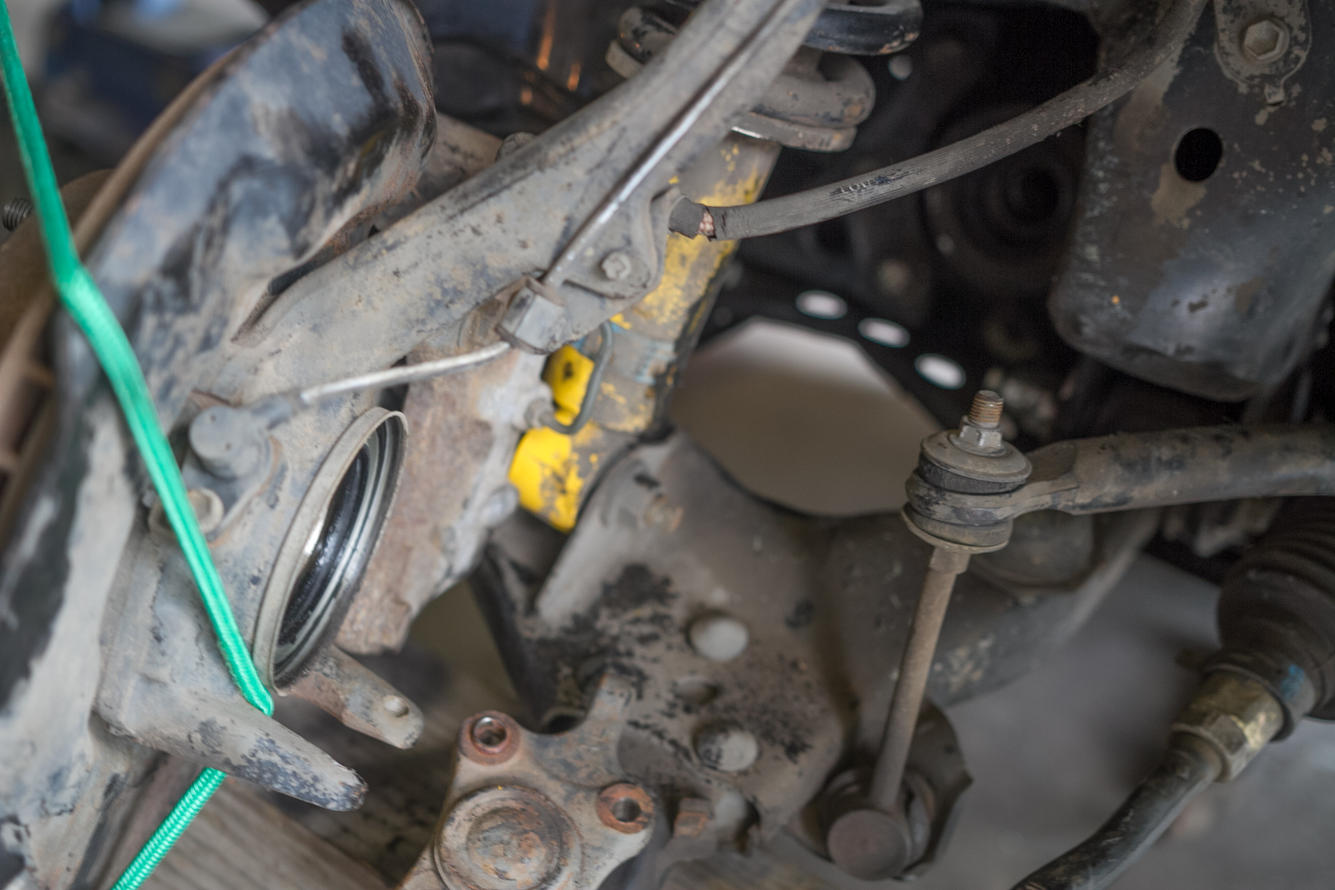

looks like with the axle out

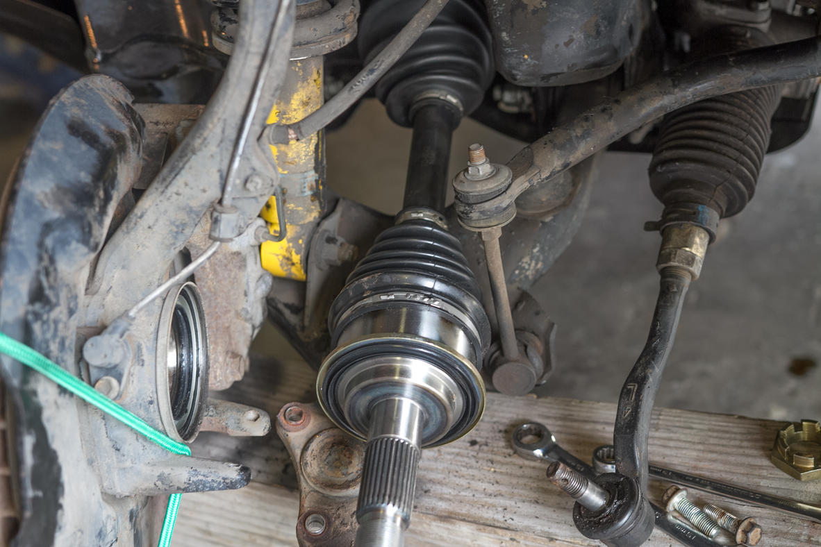

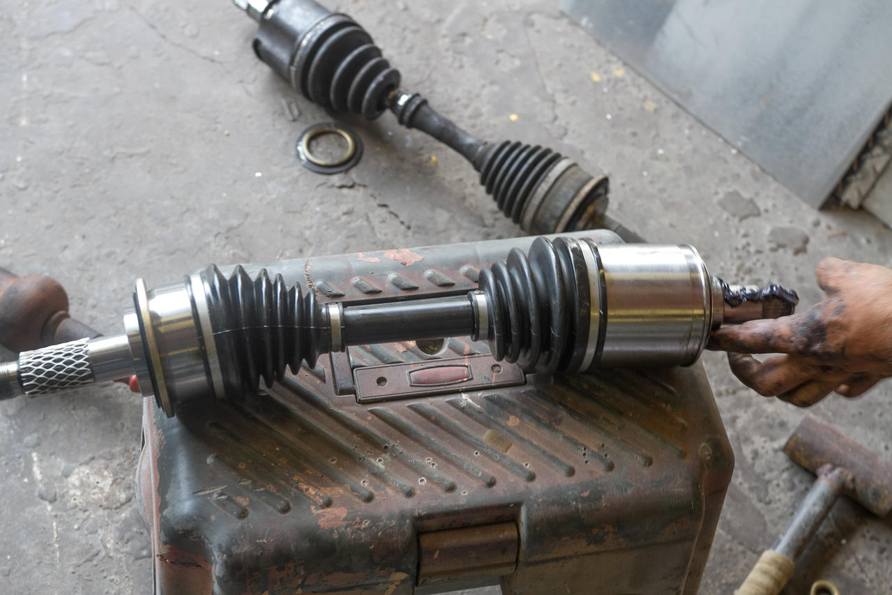

Here is the new cv axle with the torn one in the background
