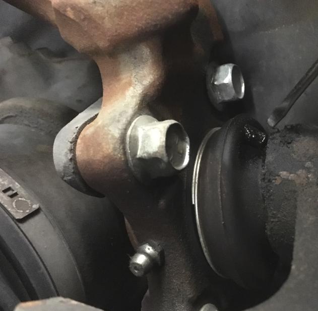

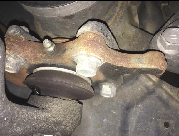

LBJ with zerk, drain?, H, L markings
What LBJ do I have on my 3rd Gen 4Runner? They have no markings cast except for an H and L. These are 1 year old.
Boot has number 20832-360-N
I guess I'll be replacing the LBJs soon with OEM, or Tacoma?
In the meantime, what kind of grease to use on these? Is that a relief drain? Do I keep pumping until clean grease comes out there?

You might not need grease, unless you have seen signs of a substantial amount leaking out. The OEM grease, when I've seen it escaping from a torn boot, seems to be thinner than standard NLGI #2. It would be bad if the OEM grease isn't compatible with what you add.
