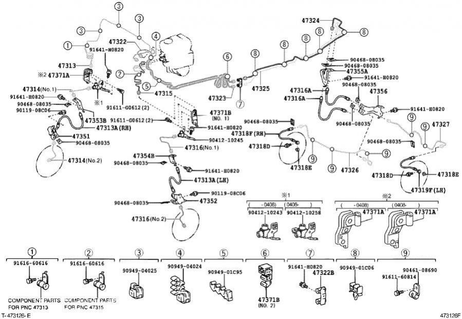

When I did mine recently, I purchased OEM lines from an online dealer, if you can take the time to figure out the diagrams and which lines you’ll need, it makes it easy putting them in. I figured I got about 20 years out of the originals so why not use the same. Another option is to get the nickel copper lines and a flaring kit.
Do you still have the info on the dealer you used? I tried finding the diagrams, but I failed.
