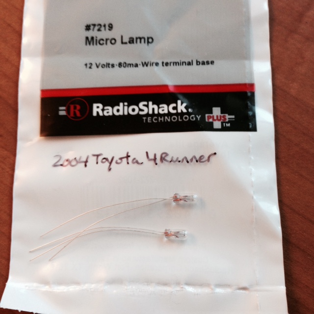

You can actually take the bulb out of the holder and just replace the bulb. You can use 12V Microlamps from Radio shack (Model: 272-1092), two bulbs for $2.
