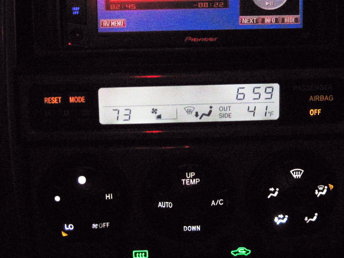

This is with t3 neo led bulbs. Couldn't get the t4 for the lcd to work. I'll need to get some more to finish out the switch gear.
Honestly tho, my OCD is kicking in with some being white and the rest being OEM orange. My eyes don't like it .. So words of advice: do it all at once (center stack + cluster). I might order some 1 smd instead of using these 2 smd led's to see if it'll dim down a bit.

I was reading the LED swap thread that the LCD screen is 7v and the LED's are 12v. They don't run. Supposedly the old non SMD T4's from superbrightled worked, but they don't sell them anymore. You can also find a constant 12v and wire it into the LED too. I'm just going to run the T3's for now in all the other switches and leave the LCD orange. You can throw that T4 into the 4wd selector tho.

for the climate control its the t4 5630 Samsung which are similar to the old t4 sold by superbrightleds, all i can say is ive had 3 different colors and all work fine. tho i prefer the white since its easier to see.
Out of curiosity, what is it about the Samsung neo's that make them work and what is it about the Superbright neo's that doesn't work? Is it the base or the LED itself? I was considering the Superbrights myself, mainly due to cost.

aside from the fact the samsung use a 5630 led which supposedly brighter than some other brands, and the ones from superbrightled use 3528, they both seem to draw about the same amount which guys are having problems with and end up doing the mod. cant explain why the samsung work but they do for me & seem a bit brighter than the old style from superbrightled i had along time ago. what has been discussed before is the t4 may need some tweaking to work, like bending the wire up for better contact, & opening up the plastic tabs to make sure they lock. sometimes if they are just slammed in & twisted they might not be seated properly.
