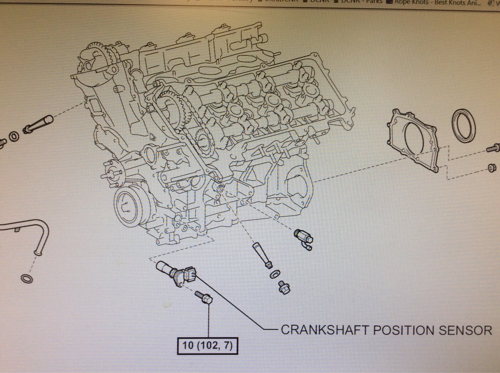

This is for a 2007 same engine. Maybe the diagram will help?
You have to remove the belt, alternator, A/C compressor, and the A/C compressor bracket. The A/C compressor lower bolts are a bit of a *****, but not that bad overall...
Thanks! Definitely helps. Also not super easy to get to apparently.
