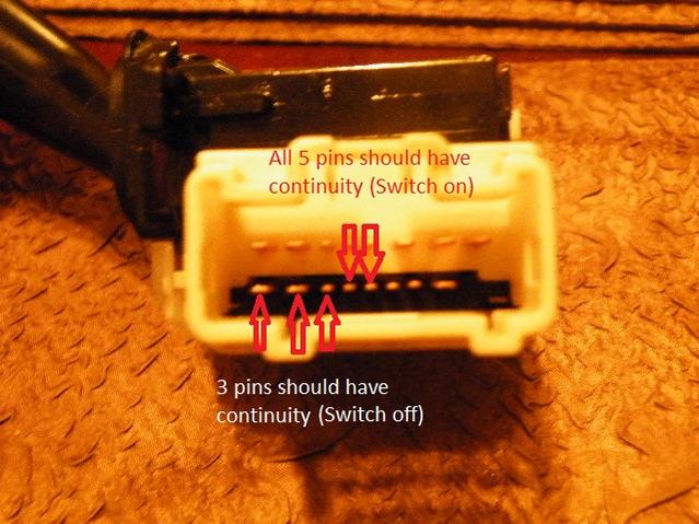

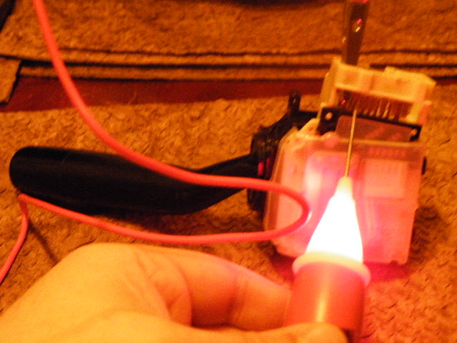

Since I have a spare switch I thought I'd share a way to test it and check for fault before replacing. Pictured is pin layout and expected continuity of a working combo switch.
