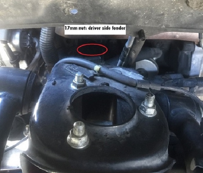

I broke my motor mounts the other weekend and now I am in the process of replacing them. The passenger side isn't too big of a problem but the drivers side has me a bit stumped regarding the top bolt. I can't seem to find enough room to access the top bolt and get a wrench or ratchet in there to loosen the nut. The only place that has any access is right in front of the shock tower but still not enough I feel like. I was able to get a 14mm ratcheting wrench in there to remove the two lower nuts and bolts on each side. I also used a shorty flex head ratchet with a 17mm socket and a short piece of pipe to break the passenger side loose. Still can't get the drivers side top nut loose!
Any input from someone with experience would be greatly appreciated!

Was a very tight fit trying to access the driver side top nut on the motor mount but I was able to ease my way to it through the wheel well just above the shock tower. I used a 3/8 flex head socket wrench. Also managed to reach it with my flex head torque wrench to torque it to spec. Did you lift your engine by the oil pan or did you use an engine lift?

I was able to get them out with a flex head ratchet behind the rear of the shock tower. Took some work but I got it out. Getting the new ones in are a whole new issue. I can't get them to line up with the motor. It got dark as I was trying to put the new mounts in so I decided to give up until the morning. The motor seems to want to pull towards the drivers side too much to get it all lined up properly. Hoping get it done tomorrow morning.
I used a floor jack with a wood block supporting the oil pan.
Had a little trouble getting the drivers side mount on last night and was able to tackle it pretty easy this morning. I pulled the passenger side mount off and left the drivers side on and let the motor down so the passenger side dropped really low. This let the engine pull further to the passenger side enough to line up the drivers side. Bolted the drivers side up, lifted the motor, and the passenger side lined up perfectly. Don't know why it didn't want to line up the other way but it worked doing the drivers side first. As for the engine vibrations with the poly mounts, I probably would have never noticed the increased vibrations if nobody said anything. The vibration is not that noticeable with our smooth running V6's. I am overall very happy with these mounts so far. It really tightens up the feel of the vehicle and adds a little more responsiveness. I actually broke both motor mounts! My engine must have been bouncing around quite a bit. Now I will have to do the transmission mount soon.
