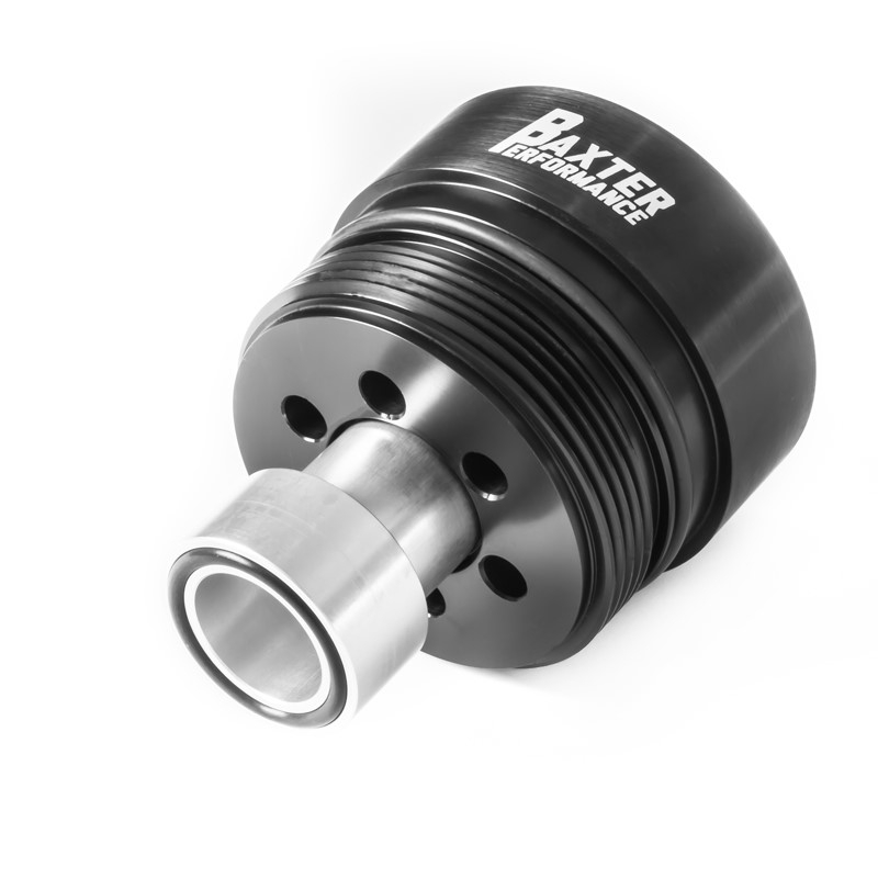

thats why I ordered this adapter specifically for the 4runner to convert it to a spin on oil filter. No more issues
Cartridge to Spin-On Adapter
