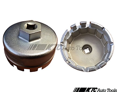

have new trd offroad and the first thing im doing is upgrading the housing to metal toyota housing
I would just remove the skid plate, pull the filter housing off completely with the filter tool and have an empty drain pan underneath to catch what comes out, pour everything out of the filter into the drain pan too. Then swap the center stem part and filter over to your new metal housing, swap o rings (since you just put them in it should be fine), and tighten up. Measure what came out by pouring into an old oil quart jug, and add that amount back in. It may waste a quart or less, but not 6.6 quarts of brand new oil.
