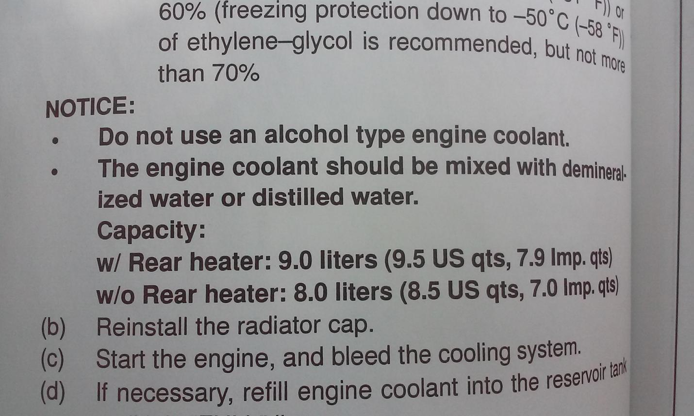

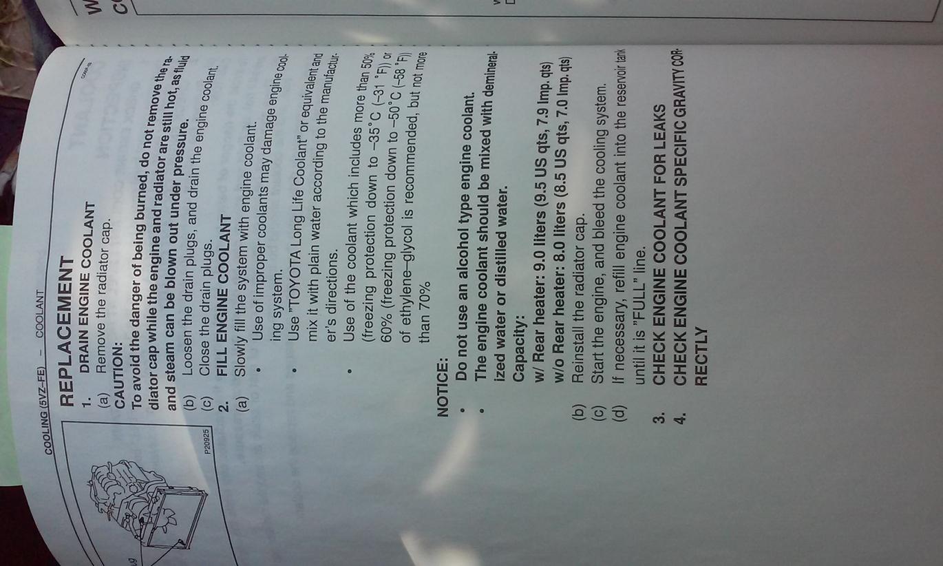

Haven't heard before that using tap water had anything to do with causing a 'pink milkshake". I thought that was due to a failure of the radiator that allowed transmission oil and the engine coolant to mix. FWIW, my 1996 4Runner service manual makes no mention of using distilled water in the radiator. It does mention using tap water to achieve a the recommended concentration. I use distilled water myself, but wouldn't hesitate to add tap water if needed.
The mineral deposits in the tap water is what accelerates the corrosion in the coolant lines which causes the rad to fail and leak fluid into the transmission. "FWIW, my 1996 4Runner service manual makes no mention of using distilled water in the radiator." - do you have a factory service manuel (FSM)? My 2002 fsm specificly states to only use distilled water, i will take a picture of the page and post it to this thread later today. If you have a haynes or similar manuel it wouldn't specify this (their usually cheaper and less accurate).
Here ya go.
