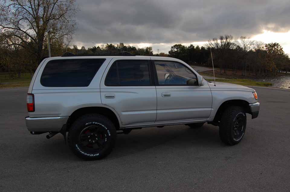

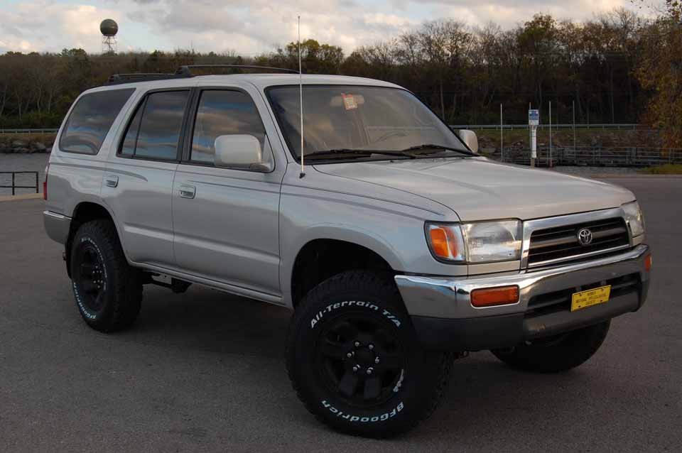

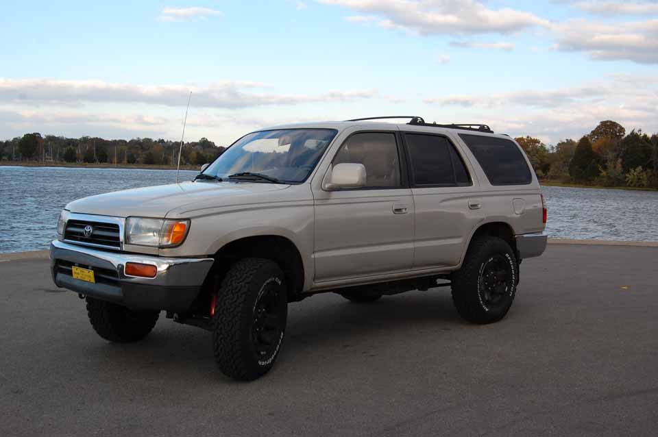

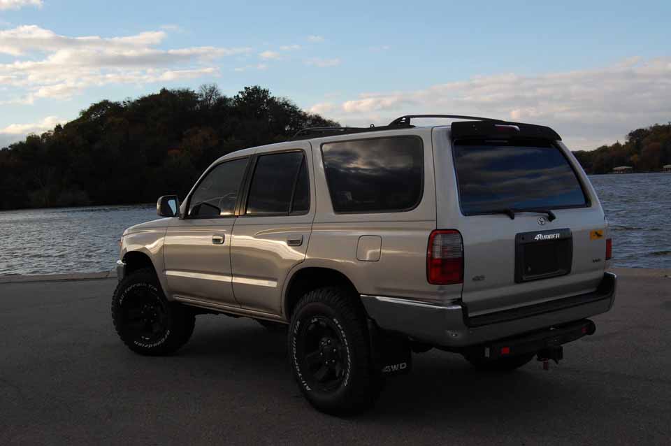

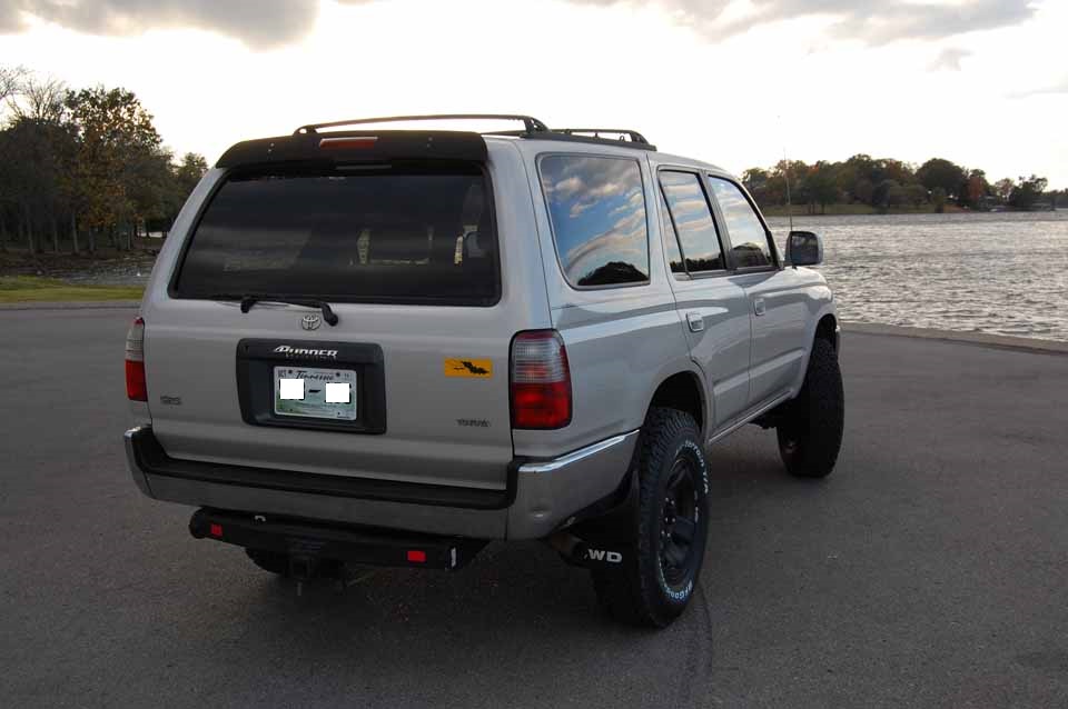

Here are my pictures of the 99s before I got the airbags. They ride great and have plenty of articulation though. You'll love the KYBs!
Before anyone tells me that the rear fender opening is lower than the front, I know that. The window trim and roof line had negative rake in my level concrete basement floor.
