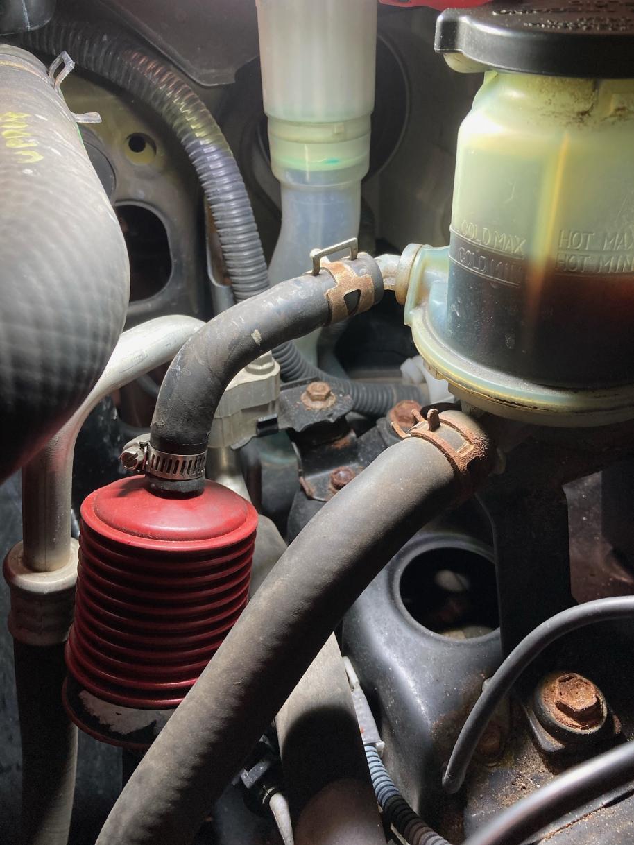

Your rack isnt necessarily bad, just leaking. The issue with hydraulic power steering is there is no filtration. The same fluid recirculates continously, and carries the dirt and grime with it. This degrades the rubber seals and creates leaks. Before jumping to the rack replacement do this first.
Flush all the old PS fluid again and Buy a bottle of AT205 from the auto parts store. Its a polymer that rejuvenates the rubber seals. Add 1-2 onces and run it for a few thousand miles. If that fixes the leak, then add a Magnefine inline 3/8” filter right before the reservoir.
I promise you, the steering will feel like a new car again within 500 miles.

Thanks for the feedback. Interesting thing is I topped off the ps reservoir after the dealer visit and I haven't noticed the level go down for a few days and the noise is gone.
